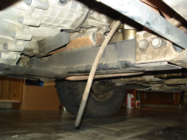

My 2000 Silverado Z71 has a hose hanging between the transmission and transfer case on the passenger side. I can not determine where the end came from or any retaining clips. I can trace the hose to the front of the bell housing where it appaers to "Y", but can not determine where hose originates.
Any ideas on what this hose is, and where its proper location should be?

It,s a breather hose for the trans and transferecase,it shoud be directed away from the cataletic converter in case oil is vented out of the transmission.zip tide it so it,s not hanging below the frame.
