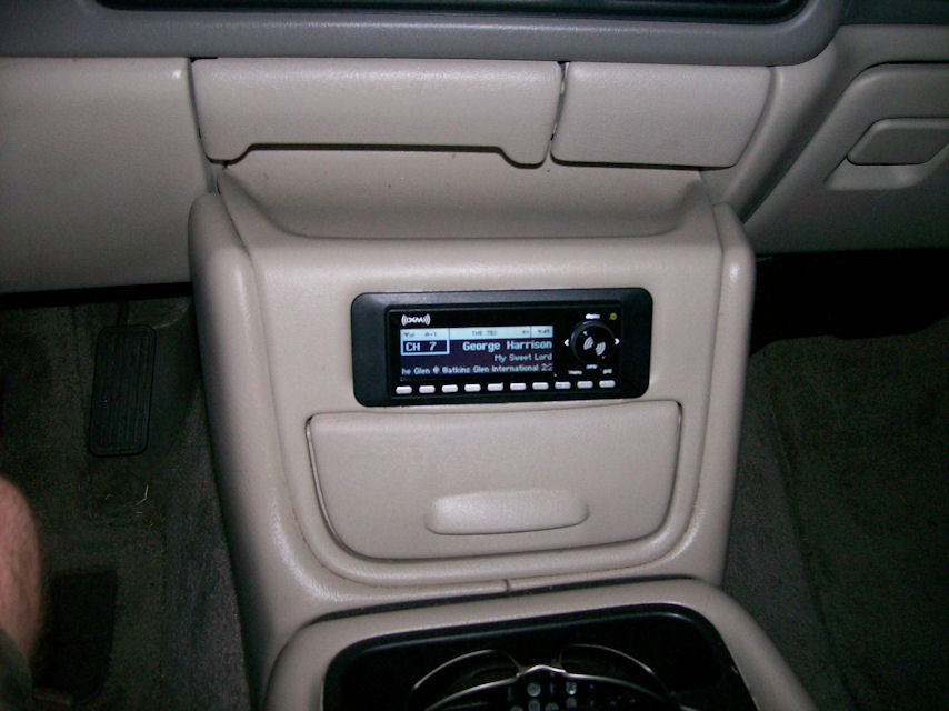

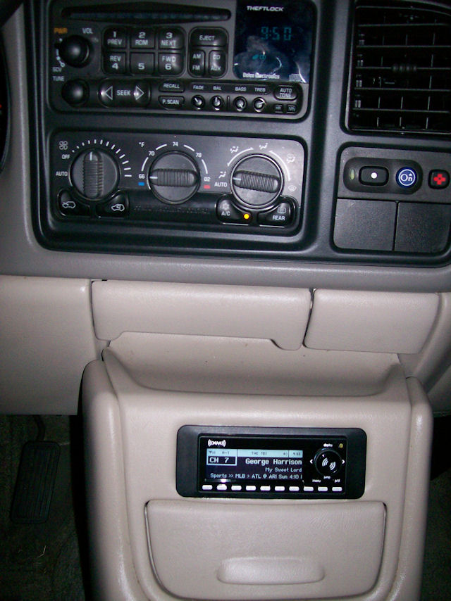

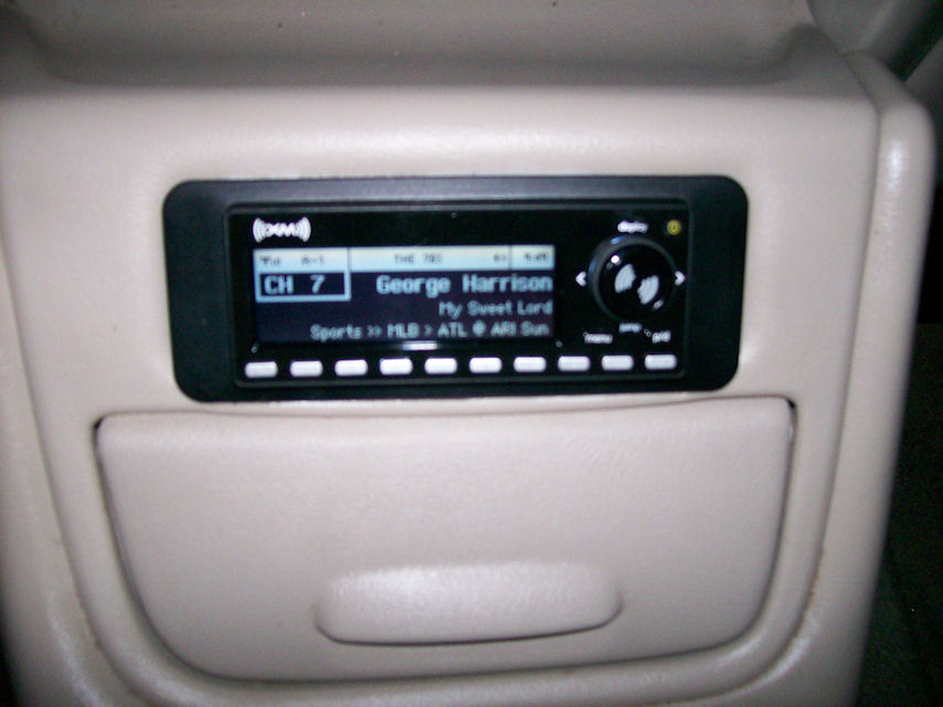

After looking at some other installs, I got excited and wanted to do one myself. I used the XM Commander MT with a PIE GM9-AUX. The sound quality is perfect and I couldn't be happier with how it turned out. I've heard nightmares about the fm modulators, even though this system came with the fm direct kit (which I guess is quite a bit better than the fm broadcast type). Here's some pictures of how I did it. I removed the factory cassette deck and installed the din plate in it's place. It's not perfect, but it's good enough for me! I tied the power into the R.A.P. and it continues to play after the ignition is off and it turns off when a door opens.
