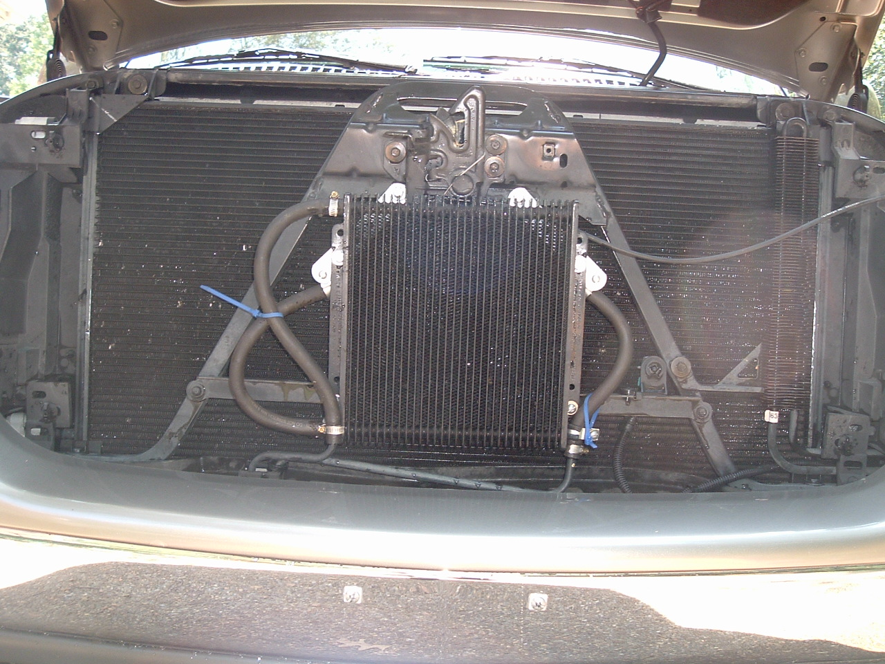

Your OE cooler is a stacked plate designed cooler. Hayden supplies our (CARQUEST) ultra coolers and we offer them in several sizes but the aftermarket coolers are not going to have the quick connect ends like your OE cooler did. Just be sure you get a stacked plate cooler and not a tube an fin. I would also recommend you stay with the 3/4" thick model and not the 1.5" models.
If you live in a warm climate, I would suggest upgrading to a larger cooler like the 9" x 11" or the 11" x 11".
Here is a shot of my 11" x 11" that I used to replace my OE cooler.
