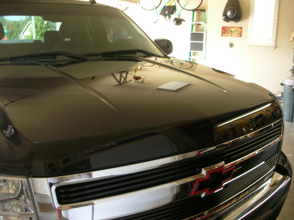

Thanks for all the help everyone. All of your answers made for a smooth install. Took me an hour and half to remove everything and mount the ballasts and put everything back together. A guy on gmfullsize has written a step by step removal instruction for the silverado headlights with pictures! The pics dont do them justice and like everyone elses, my camera shows way more flare from the headlights than is seen in reality. Still need to lower them a little to help out other drivers. :smash: Let me know what you guys think! Another good call by Daddy!

Looks good Chad. Did you turn the headlights down at all after the install to point the HIDs away from other people's mirrors? That's been the biggest thing holding me back from doing that on mine. I don't want to piss off the other drivers too much.

No i havent turned them down. My truck still sits factory height. After driving around last night i feel since i dont have a level kit i think they are fine. Plus they hit the same marks on the wall as my factory lights had.

Nice rig.
WOW! Your truck looks sick!
I LOVE the guage kit you have.
I'm pretty sure Rich would love your custom painted bowtie if he hasn't said so already.
Thanks! she sure is. Tires and wheels are going on this afternoon so stay tuned. Ill start a new thread to help the guys interested in the cooper tires. I miss camel toe daddy!
SHARP RIDE! Looking forward to seeing your new Tires and Wheels..
