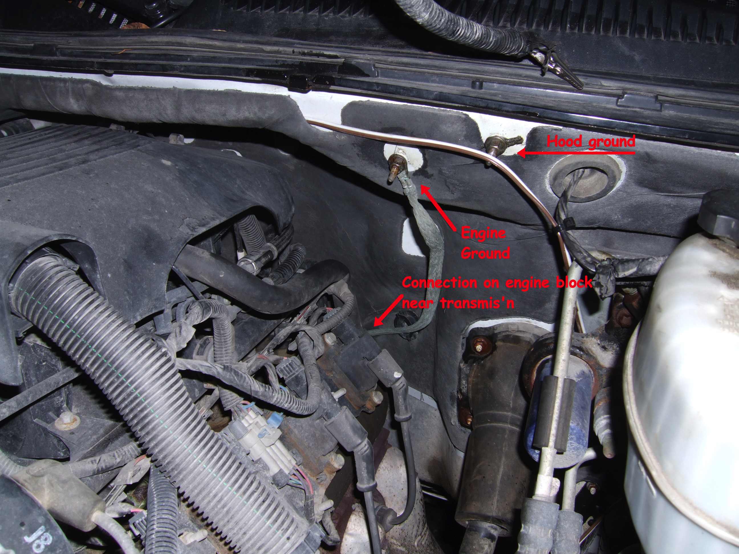

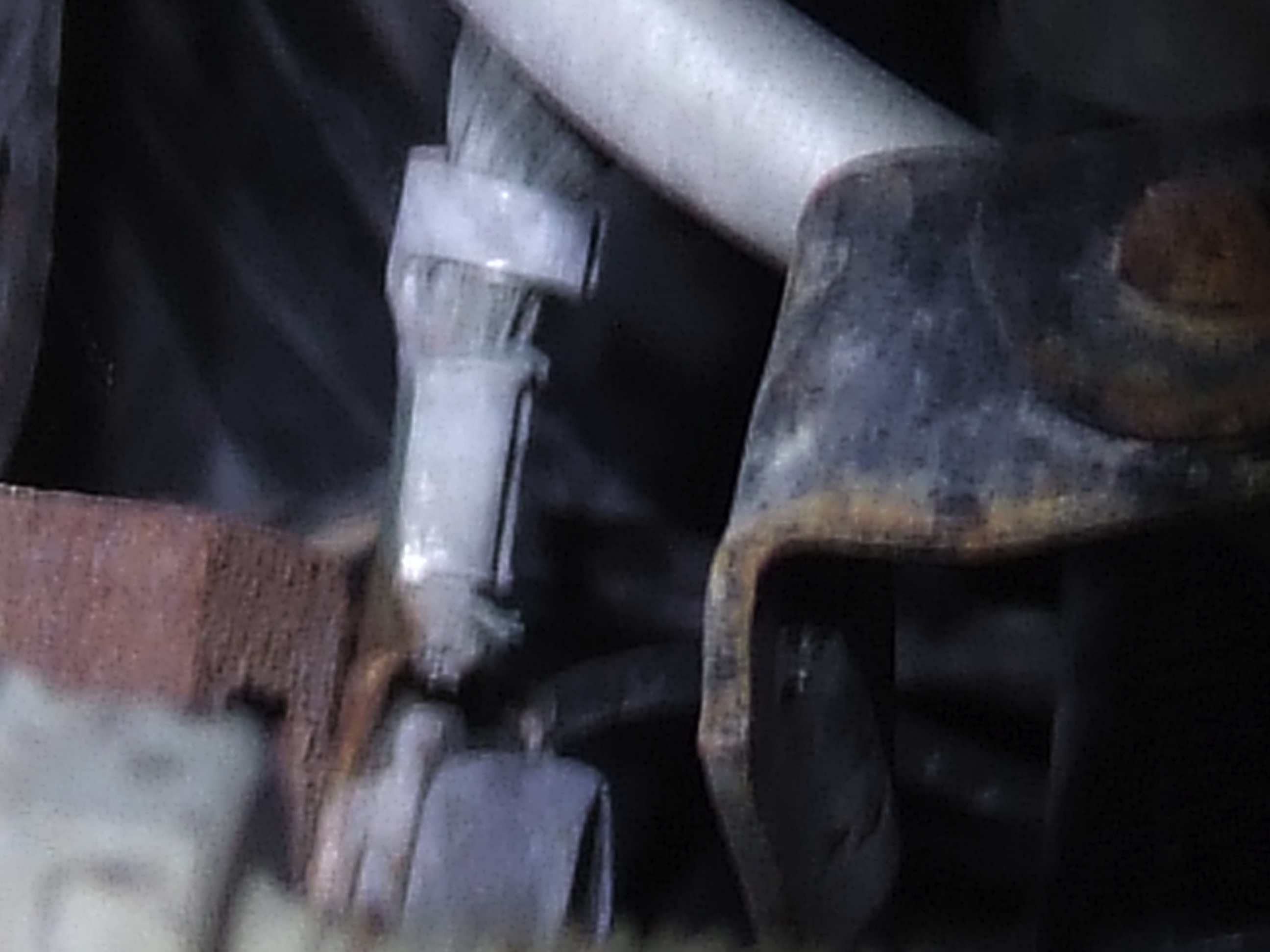

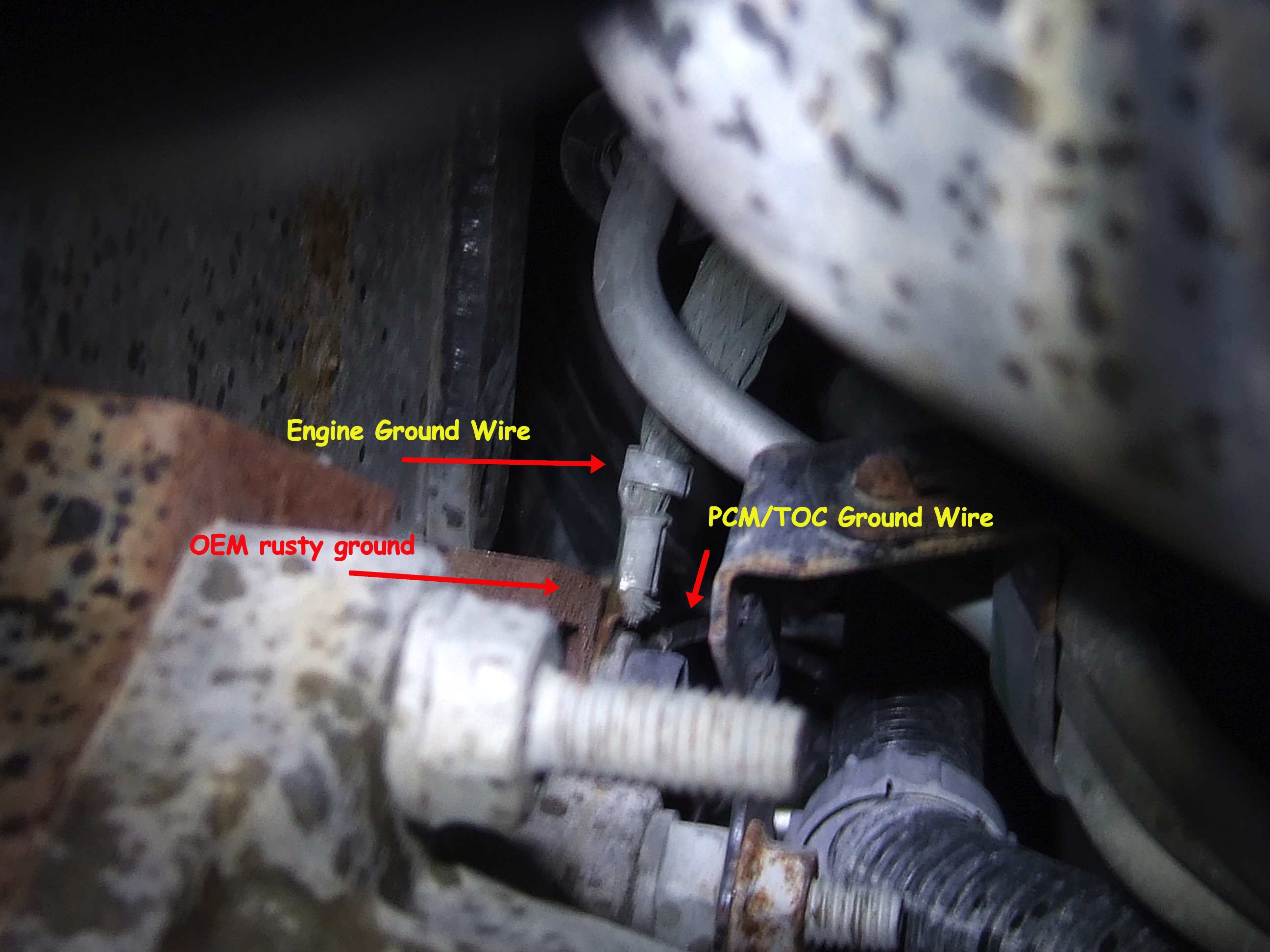

So I tackled the LHS ground point behind the engine block, using a 15mm hex key. Polished the wire eyelets with a file and reinstalled it. A few photos to enlighten the reader:
[image]http://www.flickr.com/photos/13753819@N02/3'>http://www.flickr.com/photos/13753819@N02/3'>http://www.flickr.com/photos/13753819@N02/3'>http://www.flickr.com/photos/13753819@N02/3'>http://www.flickr.com/photos/13753819@N02/3'>http://www.flickr.com/photos/13753819@N02/3'>http://www.flickr.com/photos/13753819@N02/3'>http://www.flickr.com/photos/13753819@N02/3'>http://www.flickr.com/photos/13753819@N02/3'>http://www.flickr.com/photos/13753819@N02/3'>http://www.flickr.com/photos/13753819@N02/3'>http://www.flickr.com/photos/13753819@N02/3'>http://www.flickr.com/photos/13753819@N02/3'>http://www.flickr.com/photos/13753819@N02/3'>http://www.flickr.com/photos/13753819@N02/3'>http://www.flickr.com/photos/13753819@N02/3'>http://www.flickr.com/photos/13753819@N02/3'>http://www.flickr.com/photos/13753819@N02/3'>http://www.flickr.com/photos/13753819@N02/3'>http://www.flickr.com/photos/13753819@N02/3'>http://www.flickr.com/photos/13753819@N02/3'>http://www.flickr.com/photos/13753819@N02/3'>http://www.flickr.com/photos/13753819@N02/3'>http://www.flickr.com/photos/13753819@N02/3'>http://www.flickr.com/photos/13753819@N02/3'>http://www.flickr.com/photos/13753819@N02/3'>http://www.flickr.com/photos/13753819@N02/3'>http://www.flickr.com/photos/13753819@N02/3'>http://www.flickr.com/photos/13753819@N02/3'>http://www.flickr.com/photos/13753819@N02/3'>http://www.flickr.com/photos/13753819@N02/3'>http://www.flickr.com/photos/13753819@N02/3'>http://www.flickr.com/photos/13753819@N02/3'>http://www.flickr.com/photos/13753819@N02/3'>http://www.flickr.com/photos/13753819@N02/3'>http://www.flickr.com/photos/13753819@N02/3'>http://www.flickr.com/photos/13753819@N02/3'>http://www.flickr.com/photos/13753819@N02/3'>http://www.flickr.com/photos/13753819@N02/3'>http://www.flickr.com/photos/13753819@N02/3'>http://www.flickr.com/photos/13753819@N02/3'>http://www.flickr.com/photos/13753819@N02/3'>http://www.flickr.com/photos/13753819@N02/3'>http://www.flickr.com/photos/13753819@N02/3'>http://www.flickr.com/photos/13753819@N02/3'>http://www.flickr.com/photos/13753819@N02/3 102935819/in/photostream/ [/image]
[image]http://www.flickr.com/photos/13753819@N02/3 102936275/in/photostream/ [/image]
[image]http://www.flickr.com/photos/13753819@N02/3 102935913/in/photostream/ [/image]

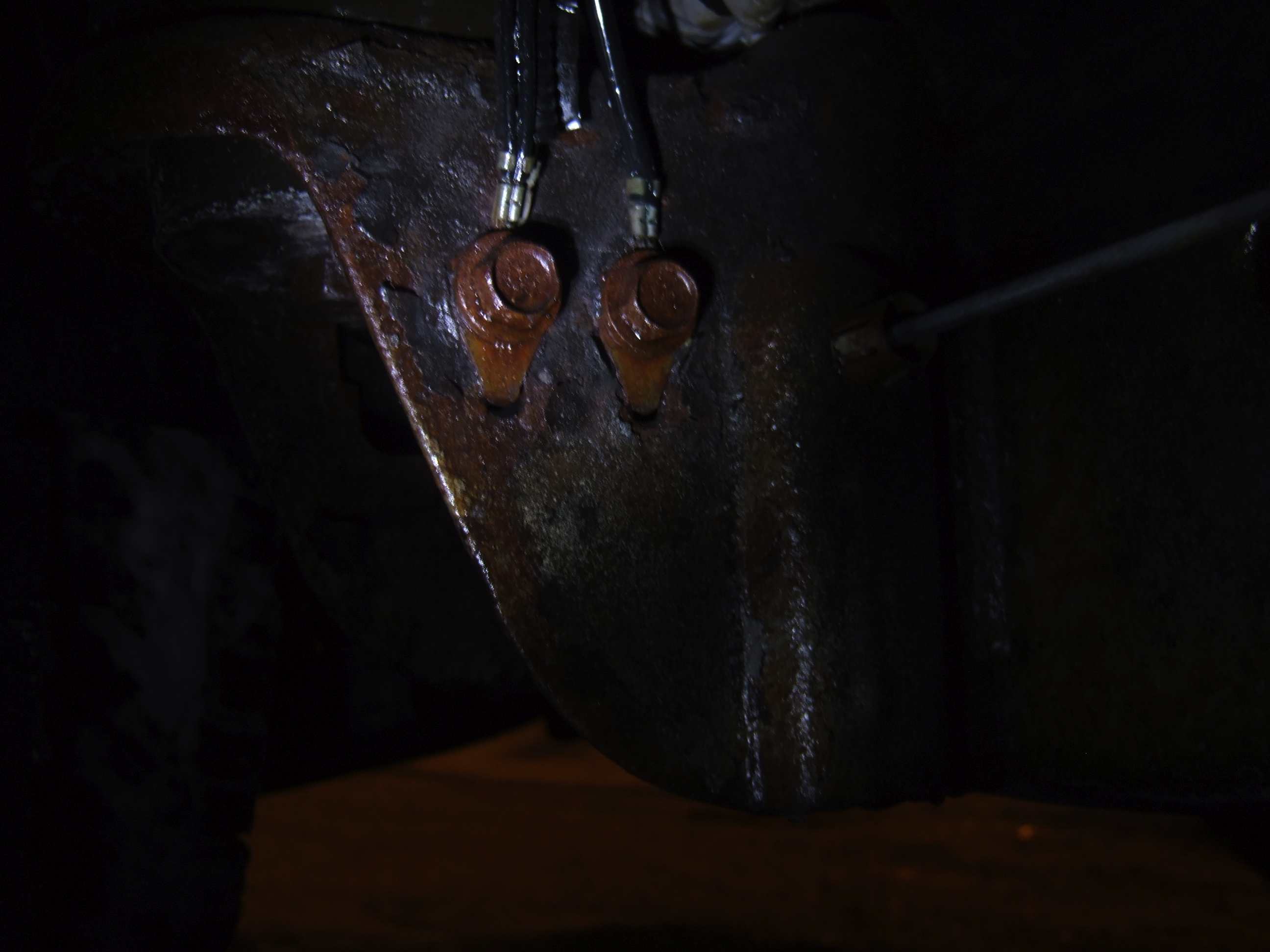

The easiest ground points to clean were located beneath the driver's door, as shown in the next photo.
[image]http://www.flickr.com/photos/13753819@N02/3 103765826/in/photostream/ [/image]
