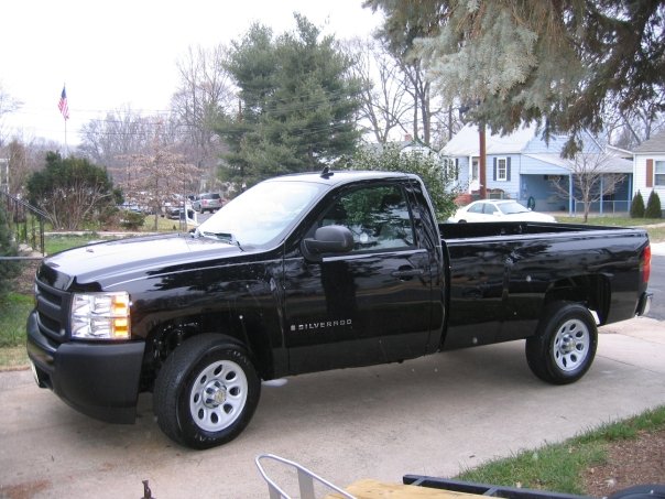

Hi everyone. Just bought my first new truck ever! - a 2008 Silverado 1500 WT 4.8L, trailering package . I love it! Blew my old 94 S-10's head gasket a few weeks back and couldn't pass up the deals.
