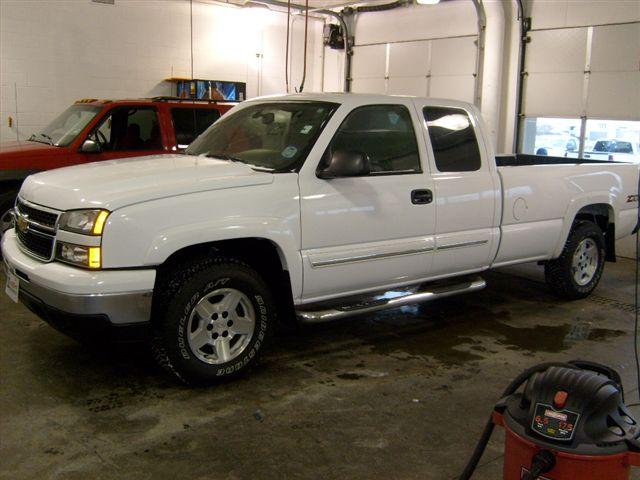

I am planning on upgrading the wheels and tires on the 2006 GMT 800 4x4 ext cab that I bought a couple weeks ago.
I am still partial to the older styles, like the American Racing Baja rims. I still preffer more tire and less rim. I would go with 16s if I could, but I believe 06 was the year they increased the size of the front rotors and I am stuck with 17s.
Here the Rim I am using, 17x8 with a 0 offset / 4.5 back spacing.
I am still a huge fan of the BFG AT KOs
The combo I use to run on my early model (2001-2002s GMT 800s)was the same wheel in a 16x8 and I ran ATKOs in a 275/70/16 size. Those cleared everything with just a very minor 1/2 tweak of the torrsion bars.
This 2006 came with 265/70/16s, and I can get the same size tire for the 17" baja's that I had befor, they are 275/65/17s, that size gives me the same demmensions as the 275/70/16s that I had befor.
With the rim being larger, I am wondering if the 285/70/17s might clear, they are 32.7" tall vs the other 275/65/17 that were 31.2 tall. The OEM tires should come in at 31.8 tall.
What would be needed to clear a 32.7" tire that is 11"s wide, mounted on a 8" wide rim with a 0 offset?
Nice truck. I too like that style of wheel. Have you checked out the Mickey Thompson Classic II wheels? They are very similar except the holes are bigger and looks better IMO.
I like the mickeys too, however they are not available, with a clear coat or chrome plated like the ones from American racing . The Chromeplated AREs are the only low maintance ones that I have found in that style. The set of 16s I had on my old 02' GMC were american eagles, less priced knockoff the AREs. I liked the rims, they were just a pian in the rear to keep looking nice.
Anyone know the back spacing or offset of the factory rims.
The factory rims look ok, but the truck came with the OEM fender flairs, that make the wheels and tires look a little funny, from the way they are tucked in side the flairs.
I think the aftermarket tires and wheels will resolve the issue, just not sure rather to go with the 275/65/17s (31.2" tall) or 285/70/17s (32.7"tall).
