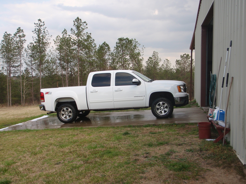

Level kit 2.5 in front with 1 in rear blocks. Going to get some 285 70 17. Thought about 295 but dont think they will fit. Any one know.
Nice truck, but some clarification please. The truck comes standard with a 1.25" block as apart of the rear suspension. Are you saying that you replaced the stock block with a 2.25" block; thereby increasing rear lift by 1"? Or, have you done something else? Just curious?

Thanks everyone.
Yes I took out the stock rear block and installed the block that came with the kit. Its a 2.25" block which gives the 1" rear lift over stock.
Looks great but as said before, need to blacken those rear fender wells. I was thinking about putting an add-a-leaf in to stiffen the rear up. Did the kit come with new shocks?
