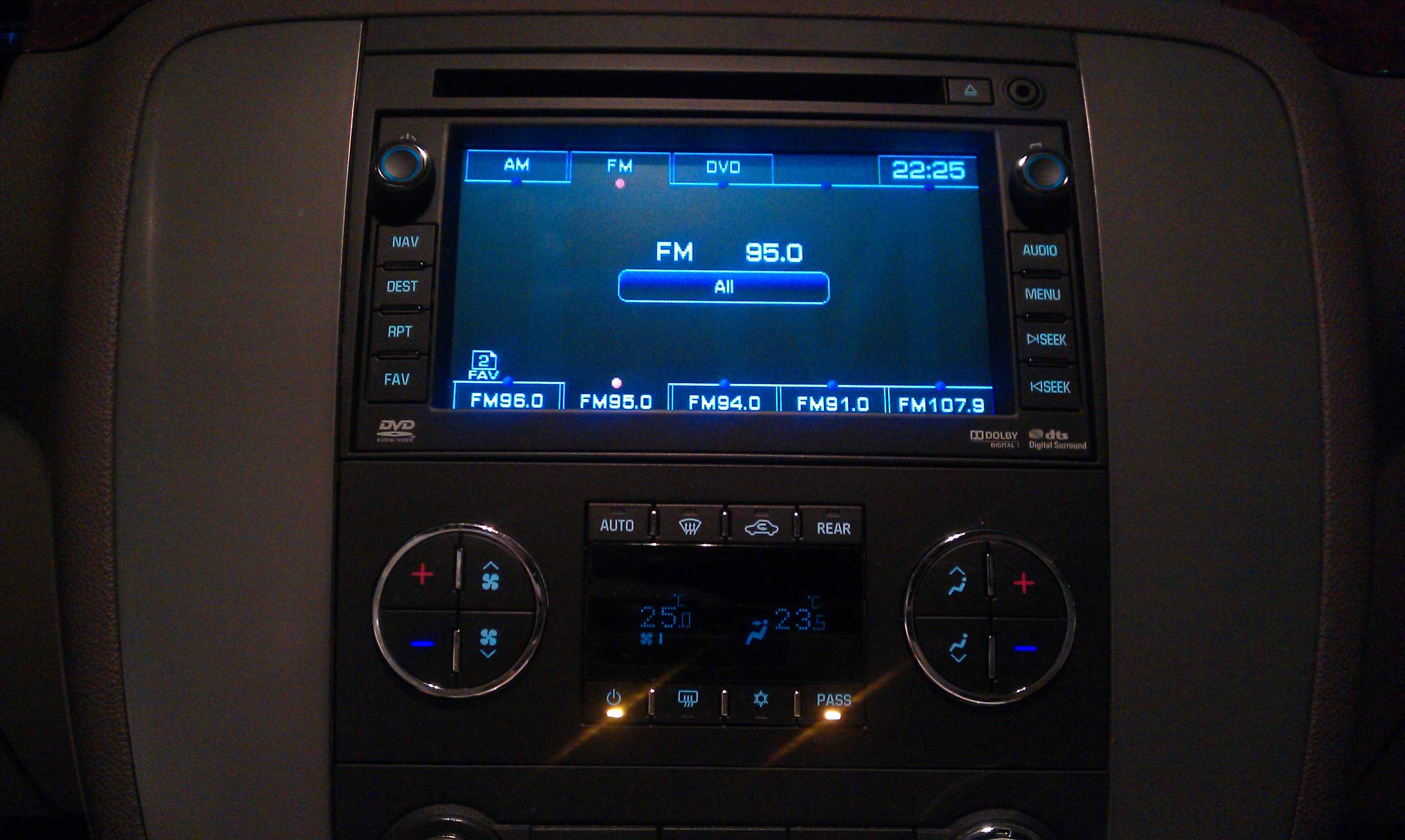

What should I do if the XM button doesn't show in the screen interface as you can see in the attached pic?
It's not going to show up unless/until you have XM hooked up. Kind of like "AUX" doesn't show up unless/until you plug something into the jack.
or the cd , when the disk is in the cd shows up in the top bar , then its gone when the cd is out of the radio
