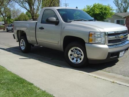

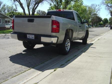

Hello everyone I have been lurking on here for a few months. I have a 08 Silverado Lt, 4.8l ,3.42 gears out back and I also have the trailer package with the trans cooler.

I noticed you guys are big on pics so I added a few of my truck!
