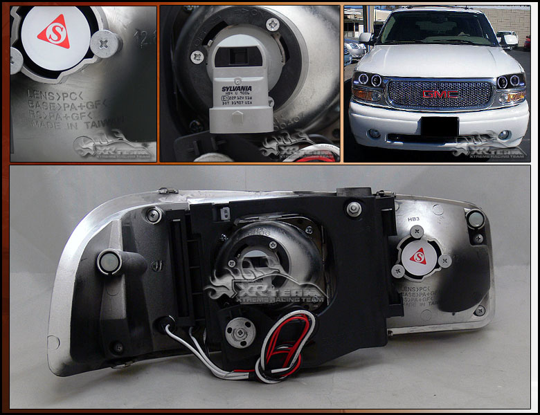

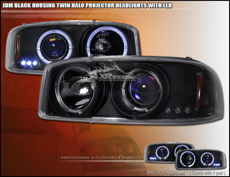

So I just purchased the headlights below, and was wondering how exactly I was supposed to wire the LED parts. Some websites say to tap them with the turn signal lights, but some say to do it with the parking light. There are two sets of wires, one for the little LED accent lets (black and white), and one for the circular projector lights (red and black). Anyone know what I can do? Thanks
Wire the LED's similar to the Audi, wire them to the DRL's of your truck & wire the halos to your parking lights or fogs. Just get some quick splice connectors to tap into the existing wires.
