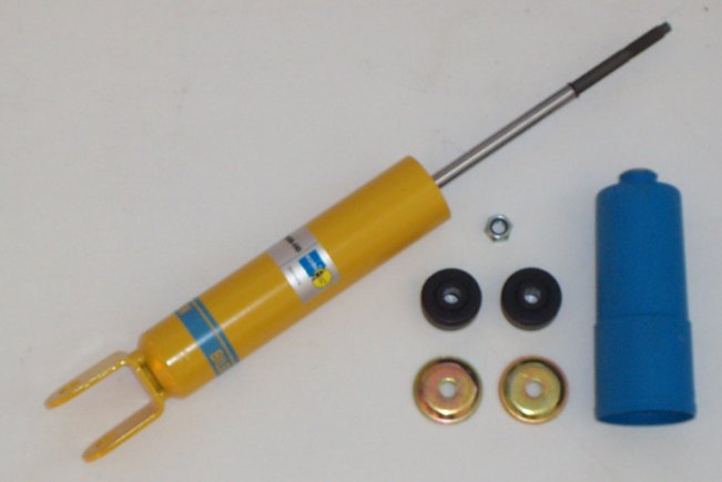

I need some help. I ordered a set of (4) Bilstein 5100's for a 2002 GMC Yukon XL. The problem is that it seems something is missing. The lower end has an inverted 'U' bracket just like the OEM shocks have, which is not a problem. The upper end, however, is only a threaded bolt. There is a hardware packet w/5 small pieces, but something is not quite right b/c I don't know how they will attach. I am a hurry b/c my vehicle is on jackstands now and I was ready to install the shocks.
Am I missing something or is this how they are supposed to be? It so, how do they attach?
No, not at all; however, the Bilstein rep at the factory told me that they were the ones that I need. I am replacing the stock Autoride shocks, so they will look different anyway, but I don't understand what the long threaded bolt is supposed to do. My only thought is that it might screw inside the dol body, but I am not replacing Bilstein's w/Bilstein's. I am replacing OEM shocks with Bilstein's.

If it is 1500 Half ton these shold be the part numbers
Front- F4-BE5-6500-H0
Rear-F4-BE5-6501-H0
If it is a 2500 3/4 ton
Front-F4-BE5-6081-H0
Rear-F4-BE5-6501-H1
I pulled these numbers of off the Bilstein Website.
They should look like this.
Hope I helped.

VictoryRed. Thanks for the help. I am going to call Bilstein this morning. That drawing puts me at ease quite a bit b/c I was afraid that I was missing something, but those parts are there. I have not taken the front shock off, only the rears and did not know that it mounts that way.
As far as the 5100's, they have greater travel. My vehicle is not lifted, but went w/the 5100's at the recommendation of the Bilstein rep.
