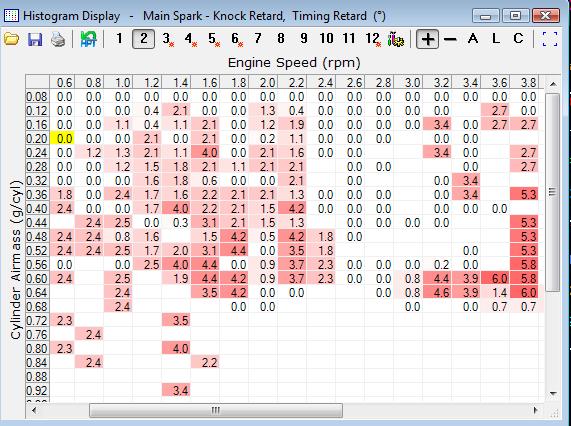

I was looking around on the HPTuners forum and it looks like we do get false knock. I will log mine some tomorrow and fill it with 93 and log again before I start tuning this thing. I don't want much, just a little performance and better gas milage.

I was playing around on HPTuners forum and found an 07 Sierra that was getting 2-5mpg better by playing with the 4cyl mode. His tune is in the repository. I will start playing with it once I get mine scanned.

On the knock, the timing pull is so aggressive that when I had the timing reduced I actually gained power. I still run and tow with 87 and it runs like a dream.

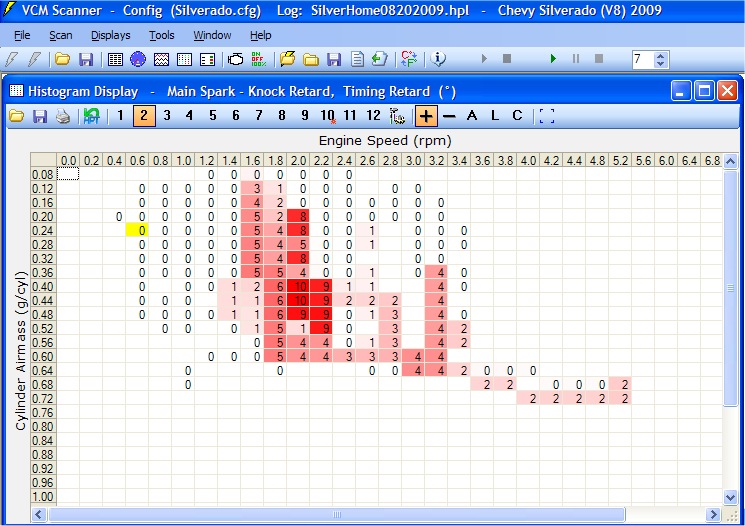

Looks like that's going to be the ticket. I filled her up with O93 last night, and saw just a couple small blips of KR on the way to work. I bet if I just remove a little of that ridiculous part-throttle advance they've got dialed in and adjust the knock settings to somehting reasonable, she'll run like a dream.
FWIW, the performance was unmistakably better this morning. It was probably helped by the IATs in the 60s...will run another log this afternoon when it is hot.

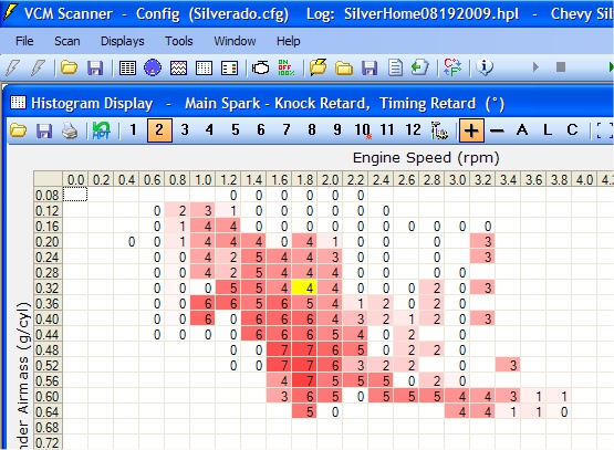

WARNING - DO NOT LOOK AT THE ATTACHED PICTURES IF YOU HAVE A WEAK STOMACH!!
If this web site has a rule against posting gory pictures, I'm sure to get an infraction for this :lol:
Is it possible I had bad gas? Moisture in the tank because it is new? WTF, over?
Three logs were the same conditions - mid to upper 80s. The only exception was the log this morning - about 60 ambient. I must have pulled the cable out when I moved the laptop to the back seat when I picked up my daughter today, or it would show some WOT runs to redline.
For those not used to looking at HP Tuners log, what you're seeing is how many degrees of timing advance is being pulled (retard) due to knock. It is set to show the maximum value that particular cell pulled at any time during the log.

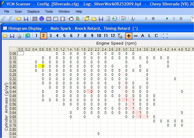

87 Octane on the way home - 19th:
87 Octane on the way home - 20th:

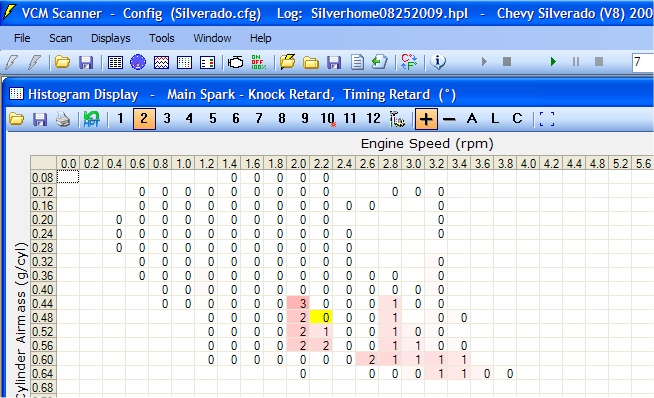

93 Octane on the to work today:
93 Octane on the way home today:
Holy crap! You sure the only thing you changed was the octane? That's a night-and-day difference.... wow. It's as if GM actually gave you a 93-octane tune right from the factory.
I wish my truck behaved like that... I still get loads of KR regardless of what gas I'm running. I just split the difference and run 89, and I've done some very mild modification to the timing tables. No wideband yet means I can't go crazy on the PE tables or any of the airflow tables.
