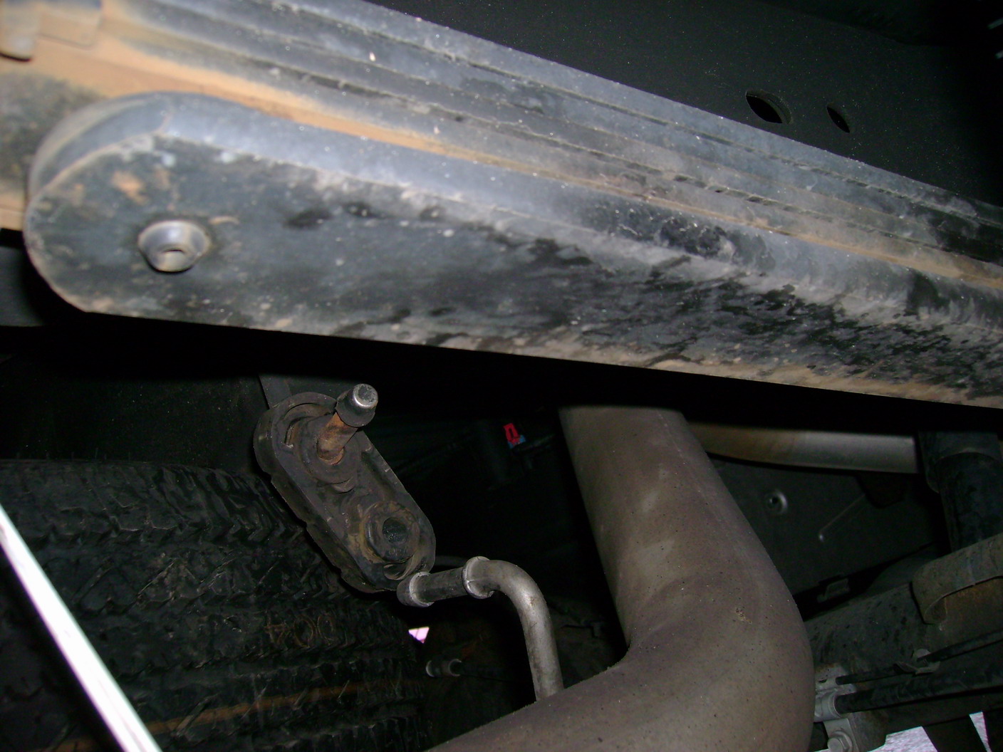

I just got my truck back from the dealer (they did some warranty work) to find my tailpipe was hanging down because the bracket was no longer attached.

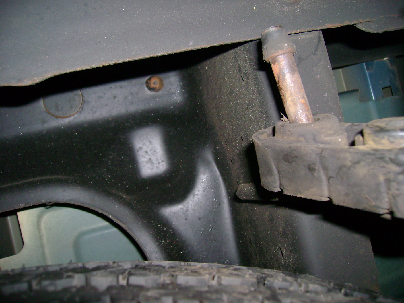

Here's my bracket - I'm going to make them replace it.
If isn't broke just hook it back up. Those things don't just fall out so maybe it was removed for some work you had done?
