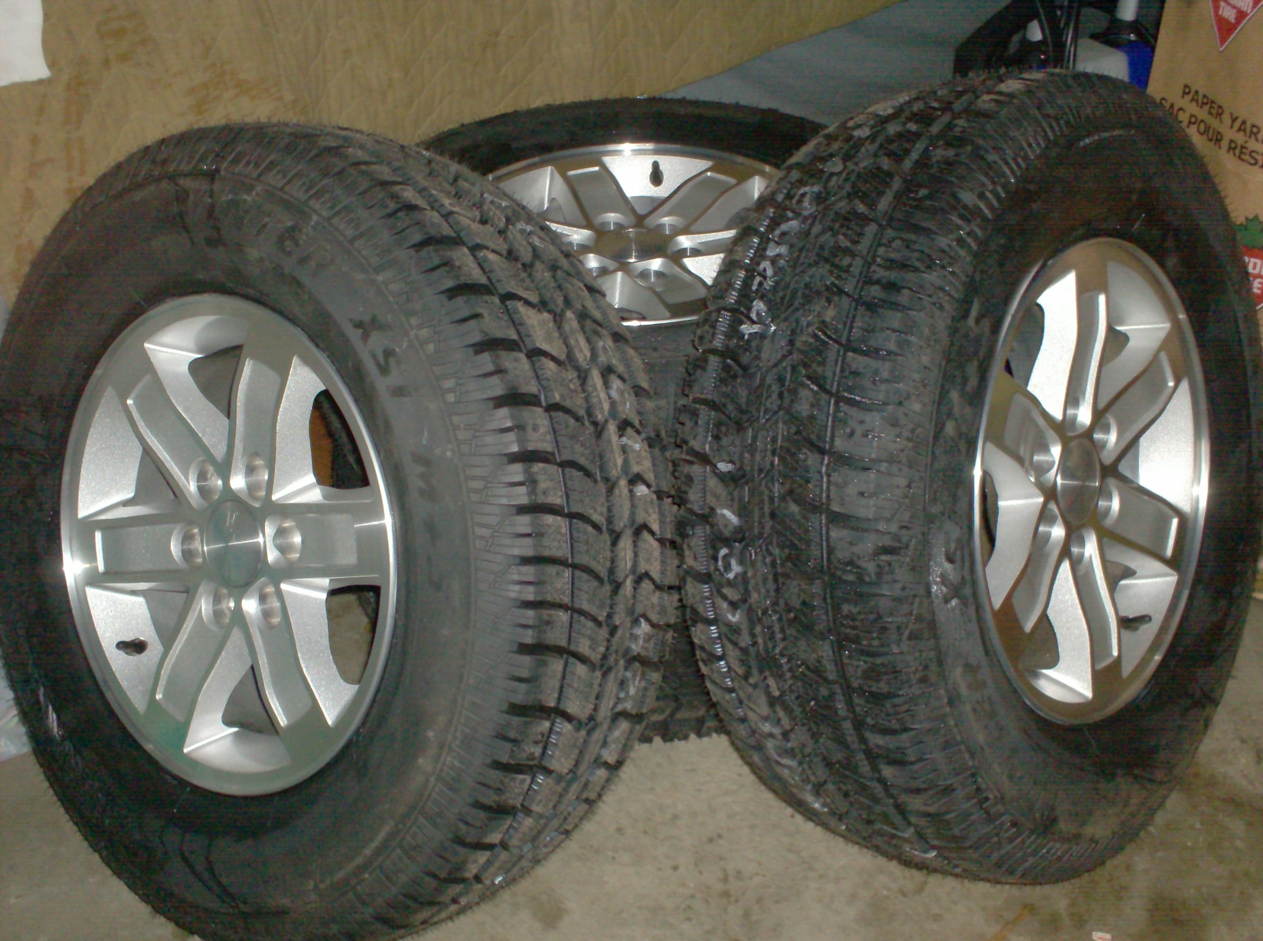

Thats a great price, did you find those on kijiji? I found my winter rims/tires on there about a month ago and couldn't be happier. 17" factory GMC rims, and Michelin LTX M/S. There is some deals on there if you know keep an eye out!
Thanks, I think I did alright?
Yes and no, it was an ad on KIJIJI advertising a tire dealer, I gave him a call and he told me he just got the GM wheels in and he could do the package for $1150.
Found out he was just up the street tucked in behind a Midas muffler shop, I didn't even know he was there.
Your set was the set I was after but had no luck, the closest I came was steel wheels with Michelin LTX M&S but they were on 245's.
What did you pay for your set if you don't mind me asking?
