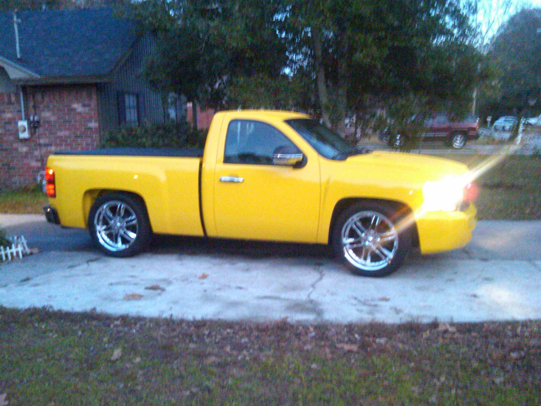

I have a RCSB 09 Silverado with a McGaughys 4"-7". It has 305/50R22 and there is no rub in the front or rear if you do a good camber adjustment otherwise the fronts will rub the back of the front fenderwells but with a 3"-5" you shouldn't have a problem with rub at that outside diameter of a tire.
