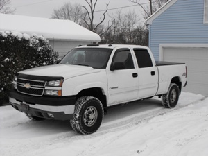

I just put a set of those Recon smoked with amber LED cab lights on my truck. I got a red silverado 2500 hd and I dont have a picture yet, but i will take one tonight and post it up. I will say this, i love them, my truck didnt come with them either so i wired them into the parking lamp circuit so they come on appropriately. The black casing with amber led really sets off the red truck.
I have a red 2500HD CC that I just installed the Pacer lights. I did the five individuals similar to the pre-99 style lights. I too don't have pics yet, but I'll try to post some tommarow if I think about it. Overall I really like it because it is unique. However, install was a PIA. But I have little patienence so that doesn't help. Worst part by far was trying to manuver you're hands under the headliner. I didn't completely remove mine, just took off the visors and overhead console and pulled the headliner down. If I had known how much of a PIA is was to do this I wouldn't have done it. Took me about five hours from the time I started measuring to finish. However, a good 1-2 hours was spent lining the lights up to make sure they were in the right place before I drilled 15 holes!
Yea i agree, every time i started drilling into my 06 cab it hurt me down deep, and i asked myself, wtf am i doing. But the outcome is worth it. Took me and a buddy an hour to mount them and 45 min or so to figure out where to wire them to. Granted i only have 3 lights but I still measured 30 times lol.
i would certainly do these again on just about any truck.

Here are mine. I used the Recon lights and love em. I measured the lights on a factory install then measured for mine numerous times before I drilled. It hurt putting holes in the roof but the outcome was worth it. I recommend using grommets or silicon around the screw holes and the hole for the wires. Good luck!! You'll love em!!
