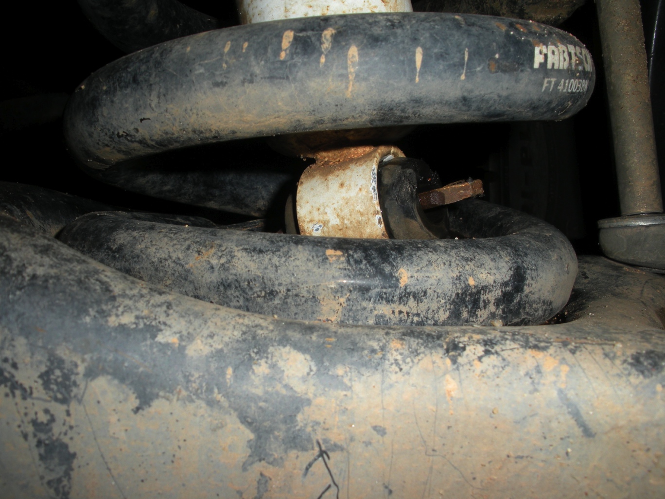

I've noticed a random bump in my front suspension that's been happening for years and I've looked but I've never found anything that would make it do that and neither could any mechanics when I took it to the dealership for preventative maintenance. I always thought it was just some play in my front light bar. Fast forward to today. I got some new shocks in and I was comparing them to make sure they will fit before I get them installed on Friday. As soon as I checked to make sure they would fit, I notice a difference between the lower shock mounts. I can't believe I've been driving the truck around this long with the front end like this.
On a similar matter, does anyone know where I can get the bolts for that mount by Friday? If I don't have them, I don't think I can get the new shocks installed...
Right side (normal):
Left side (holy s***):
Take that one remaining bolt out of the left hand side. If there is a dealership close see if they have one on stock, if not go to a local hardware store or parts store. All you really need to do is get the right size, try to get a grade 8.8 or 10.9 if they have some.

wow, if you've had that thing at the shop multiple time for a front end noise and that was broke the whole time.... id recommend finding a better shop!
You might want to check if the threads are stripped. My old car's threads rusted so much that when I put new shocks on it, both bolts on one side shot out when I hit a big bump. I ended up having to fish bolts through the top so I could put a nut on the bottom. That was not fun.
To address the title of your post. It appears you lost a bolt and it was too much stress for the remaining ear to handle.
I see no harm in replacing all 4 bolts. That is what I would do in your situation.
