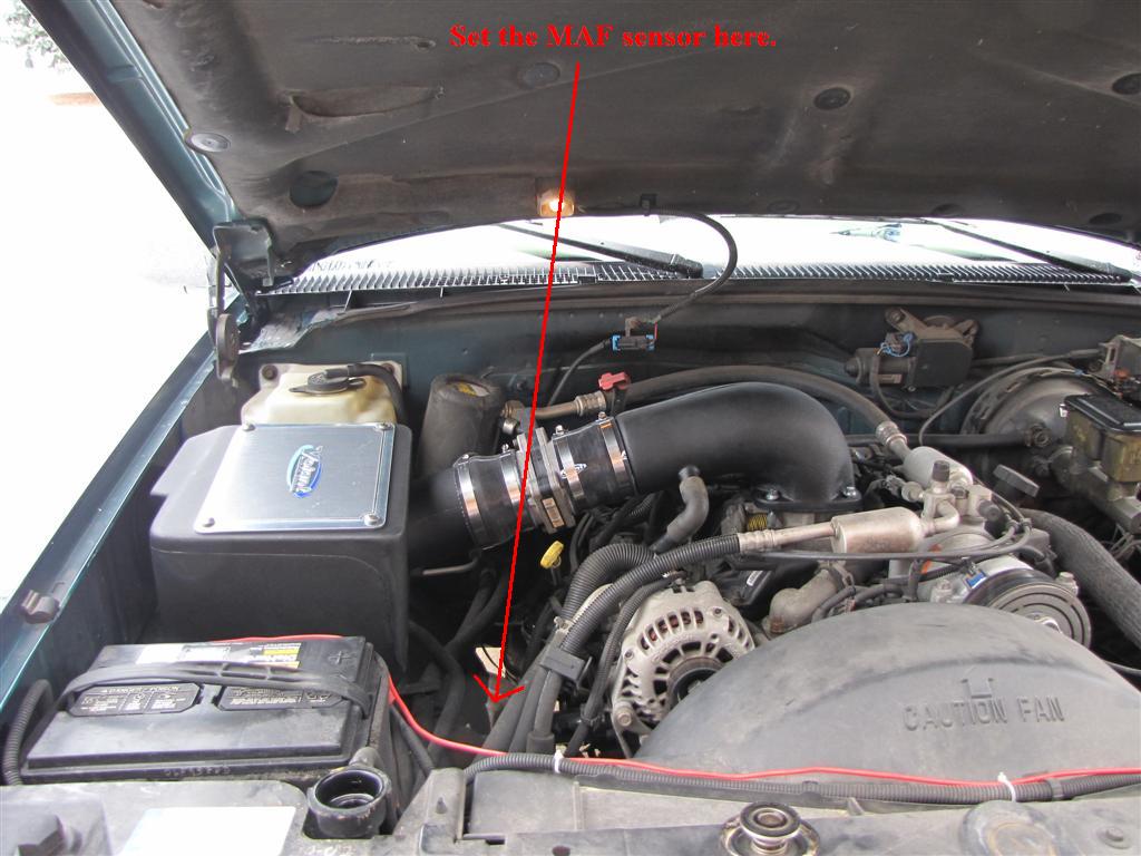

5) Once you get the MAF sensor separated set it up on the A/C canister (silver can right next to the coolant overflow jug) or lay it down resting on the inner fender and A/C lines running forward to the condenser
- setting it on the inner fender is much safer and you can't drop it as easily but it will stay in both locations

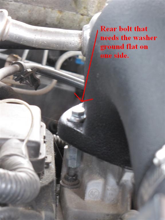

9) Flatten one side of the washer for the bolt closest to the windshield that bolts to the intake manifold
- there is not enough room for the washer to fit round; one side must be almost completely ground away and even then it doesn't sit very flat

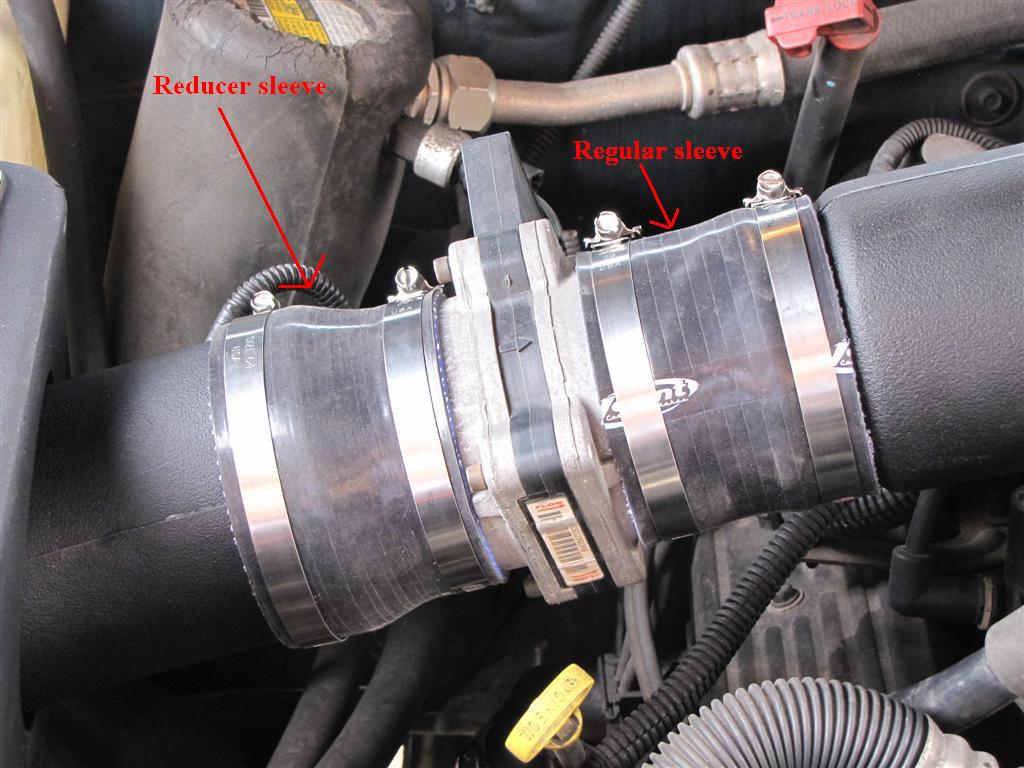

12) Put the Volant in in this order
- 1) Bonnet (what bolts to the throttle body)
- 2) Filter box
- 3) Rubber boot from bonnet to MAF sensor
- 4) MAF sensor (make sure the arrows point the right way for airflow)
- 5) Place the filter and corresponding clamp in the box
- 6) Plastic tube into filter through opening in box
---- Make sure the Air Temperature Sensor is pointing towards the firewall so the plug will reach
- 7) Rubber boot from plastic tube to MAF sensor
- 8) Connect Filter/Plastic Tube/Rubber Boot to MAF sensor

I know what you mean. It was kind of a stretch even with the supplied couplers. It seemed to tighten down good though.
