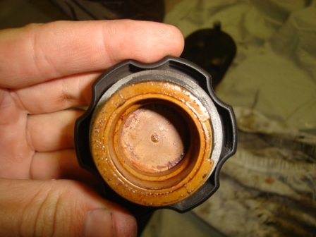

Thanks for the reply. I know I have an external leak. I change the oil every 5000kms with syntec (probably don't need to) and have never noticed any milkyness or swirls in the oil. Under the oil cap there is no sludge. It has an orange colour but that's it. It's nothing that you can wipe off with your finger. All in the top of the head and on the under cover of the valve cover looks good as well. Can't see any pool of coolant anywhere, but I suspect my leak is at the back passenger side of the head where the cooling journal is. I was tempted to take the valley off that reveal the pushrods just to see if there was any inside of there.

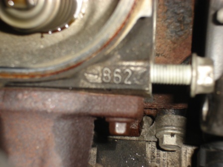

I don't believe I have bad castings, not ruling it out. They are 862 castings, and from what I have read, are not affected.
