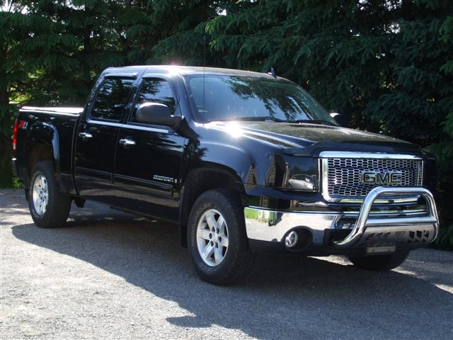

Thanks guys, Chris 07, heres a pic, its an old one, but all I have on the computer right now.
man that looks good, I plan and getting front and rear covers also, also the hum is normal I got the 35 watt kits and they do it too.
