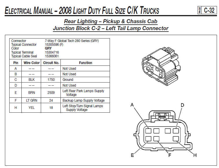

EDLEECRI Posted April 1, 2010 Posted April 1, 2010 Can someone tell me which wire to the back up lights is power, there are two black wires and one green wire going to bulb. I have looked for a wiring diagram with no luck. This is for a 2009 Sierra 1500. Thanks for any help, and yes, I am a brainless twit.
mfennema Posted April 1, 2010 Posted April 1, 2010 It is the light green one. Check out this page. The right side connector is the same.
EDLEECRI Posted April 1, 2010 Author Posted April 1, 2010 Thanks much for the info. That is what I needed. It is the light green one. Check out this page. The right side connector is the same.
