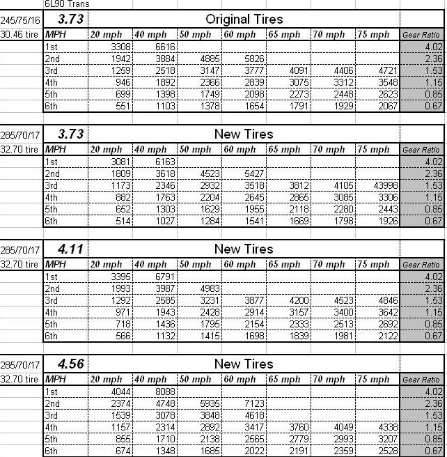

I just put on 285/70/17 on my truck, 6.0 gasser with the Allison 6speed, and think I want to regear. I have 3.73's now and cannot decide on 4.11 or 4.56. Afraid of not enough of a difference or high reving engine on the hwy. Right now I am at about 1800 RPM's at 65mph. I was thinking 4.11 but the guy at the axle shop thinks 4.56 would be better. Anywhere between 45 and 65, it does a lot of down shifting. What is the ideal rpm at either 65 or 70mph to get good gas mileage and have good power. Any suggestions appreciated.

I ran the calcualtions and I think the 4.11 is the way to go. Thanks for the insight. I thought all of this time, my trans was the Alison and I thought my final drive was.70. I think the 4.56 is too low for the type of driving I do, mostly highway. I do have a programmer, the Edge CS and it made a huge difference. It firmed up the shifting and has increased the Torque substantially. I just want it to be even more responsive. I think I am being plagued by the Torque management system and that is what I am feeling. The Edge is supposed to adjust the TM system depending on the current conditions. I think getting back close to stock on gearing may also help gas mileage because of the bigger/heavier wheel and being a little higher in the powerband.
