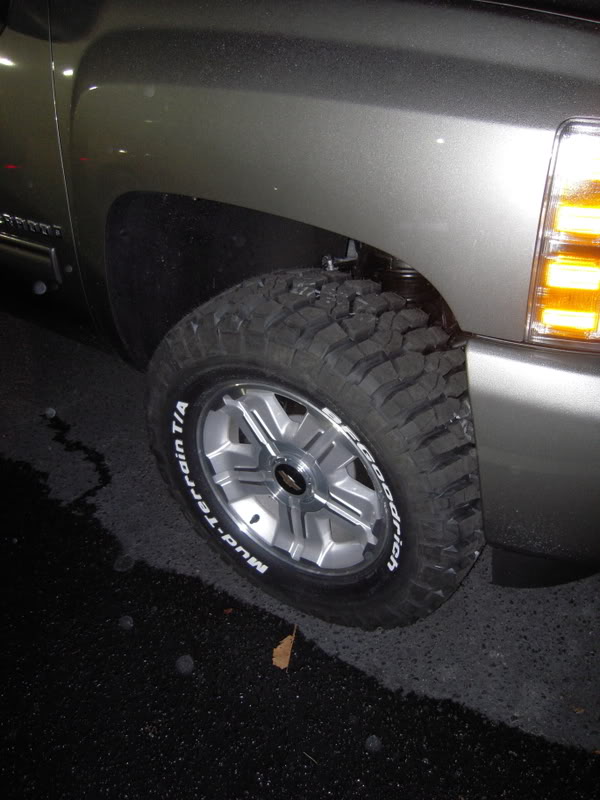

I put the 275 65 18s on my truck without the leveling kit and didnt rub at all. I tryed to make it rub, backing up over stuff trying to make it flex (ifs, yeh right) and they didn't. After i added the leveling kit i added to the space and theres no way it will rub now. Right after i did it and posted it, someone did what you are wanting to do with a 08 i think but those are both trucks, not sure about the tahoe. I think if you get a leveling kit they will fit on the factory wheels, any other off-set is going to rub. i have seen with leveling kits and stock wheels, 306 60 18's will fit so i don't know why those wouldn't. theres a picture of mine before i leveled it.
