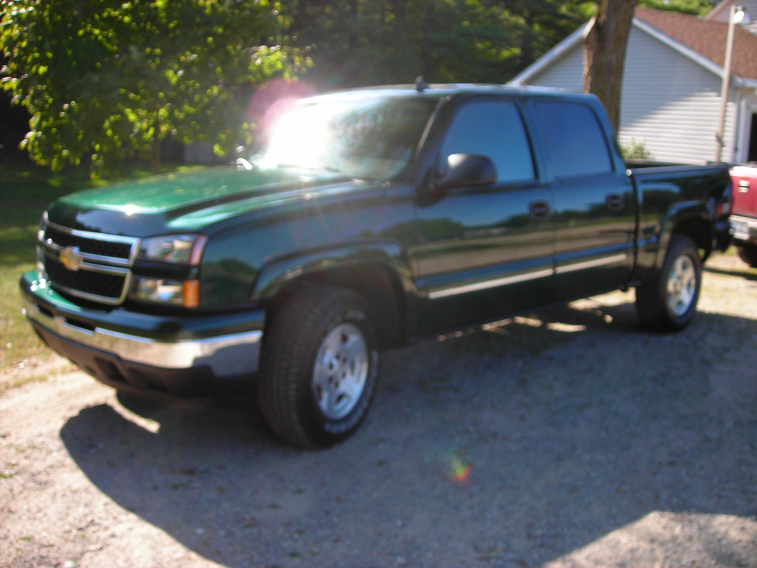

I have a question in regards to changing the plugs and wires on my 06 Silverado Crew Cab, they don't have to be done yet, but when I do have to do them, it is just like a normal plug and wire change? Other thant he plugs and wires being different, it is pretty straight foward?
Thanks!
Hey crewdude I have the same pickup as you. Its all just the same but one piece of advice. I dont know my cylinder numbers but the cylinder closet to the firewall on the passenger side can be tricky. I was using a 1/2 in wracthet and a 5 inch extension and it worked fine on every other cylinder. But on that particular cylinder it would not work. The fire wall was in the way with the big extension and the manifold was in the way without any extension. I had a little stubby one inch extension the worked like a charm.
