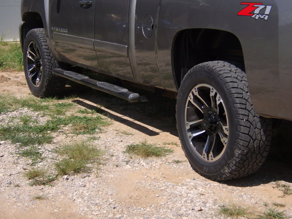

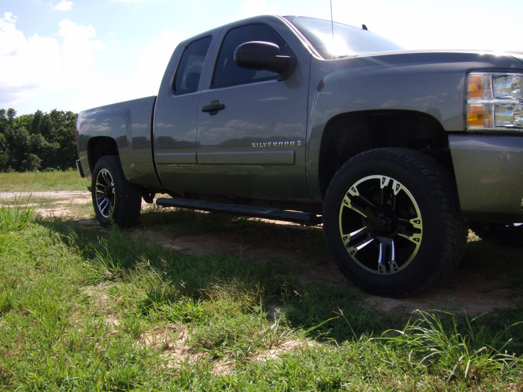

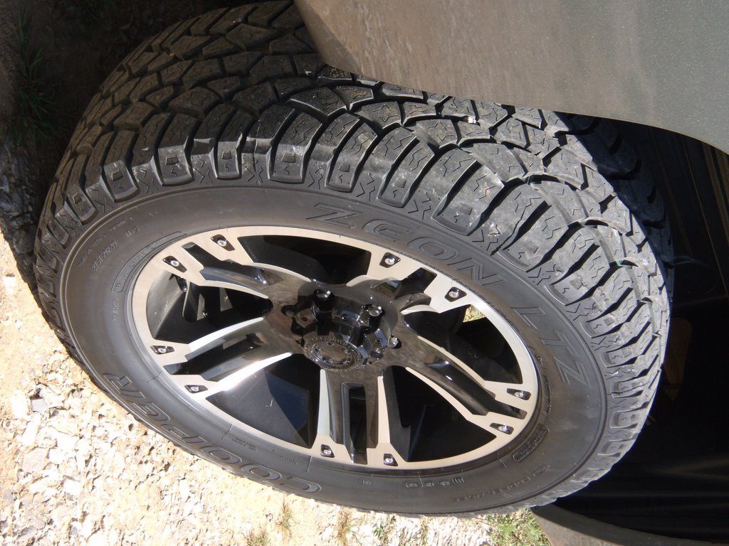

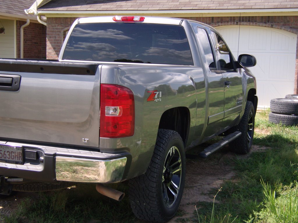

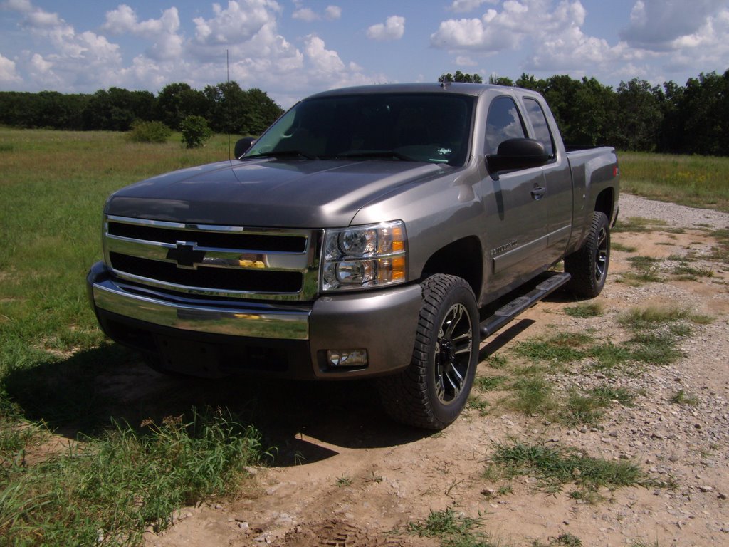

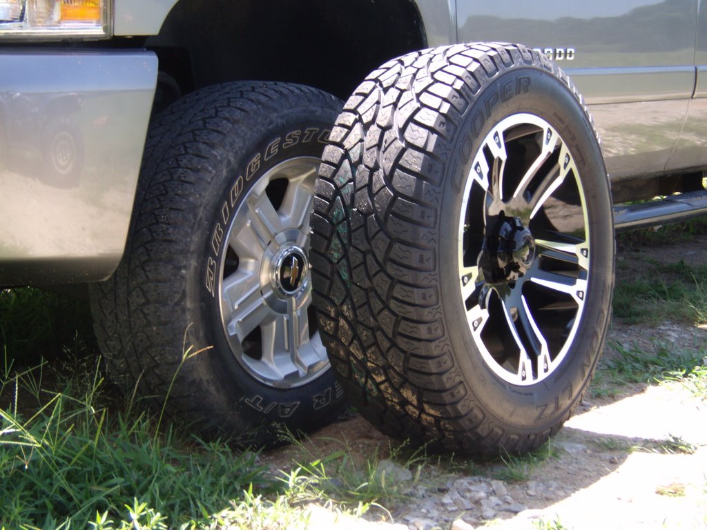

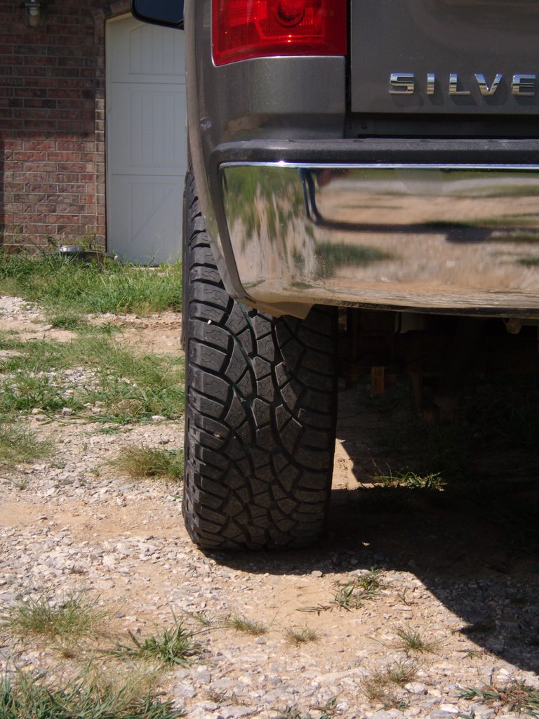

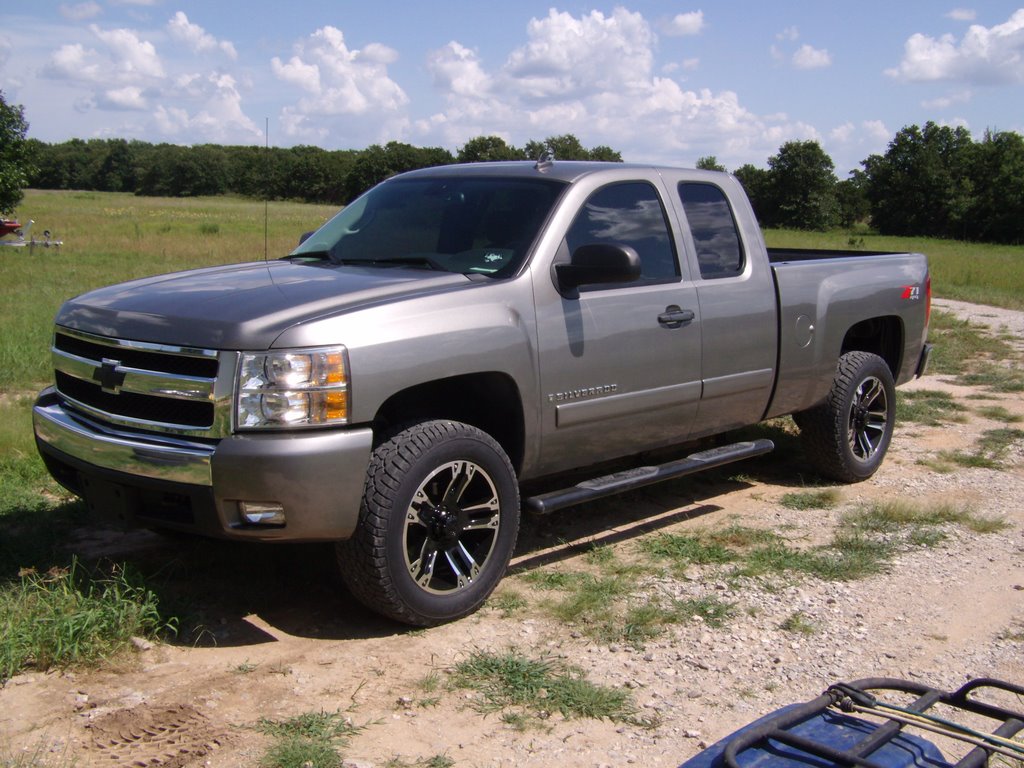

These turned out nice. Honestly better in real life than pics. Rides better than the stock tires (smoother). I know these look even better if you get the wider size cooper, 305/55's i think they are, I've seen them, more space between the treads, but these look better than I was thinking and won't stick out and throw rocks and mud as bad.
I was suprised at how light these were. It looks like it would probably rub a little on the plastic if you turned it just right when the tires are still new, but no biggie. Wouldn't want to go any bigger though.
Wheels - Ultra Mavericks 20", 18mm offset
Tires - Cooper Zeon LTZ 275 60 20
Truck: Silverado LT, 1.5" level, 1.5" Body Lift

Looked like they might rub a touch on that front plastic piece, but it just kinda hangs there. If you push the plastic with your finger you can move it an inch, so it's not like it's really going to hurt for it to touch it. It's flimsy. Nothing like rubbing tie rods, etc., or anything you'd have to modify.

Yep, they definitely look good! I wish I would have got black rims instead of chrome, but styles have changed since then.

Looks real good! I have the same set up just diff rims.I love the Zeons and yes they still hold some rocks but nothing like the stockers.gas mileage has dropped though.I have zero rubbing even through the rough stuff.Tires are a huge improvement over stock

how much mileage have you lost per gallon? 1? 2?
also - won't the 275/60/20 fit on a stock GMT900 with a 2" level with no rubbing? right?
I doubt it's more than 1 mpg, if you correct your odometer anyway. These things seemed just as light as the original tires. It'll switch out gears more often though going up a steep hill, but then again it's running at a lower rpm the rest of the time. My truck isn't tuned at all at the moment though and running E10 87 oct.. I don't figure it will switch out gears much after I get it tuned up.
yes they'll fit, if they rub any it'll be rare and won't be enough to matter, assuming you're talking about stock wheels. You're just about an inch lower than mine in the pics.
