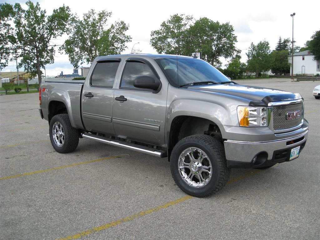

look at the pic in my sig, that's what 3" blocks look like with a level kit up front.
i did a 2" rc level, then added the 3" superlift blocks to the rear. it brought it right back to stock lean. in my eyes it looked like a taller, bigger truck with just the level. so then i added lift spindles and leaf springs. the truck looks waaay better level, not to mention that youll want to add new rear shocks because those blocks will stretch the oem ones and ur ride will become a bit bumpy. just my opinion

see sig...2" front, 3" rear...
