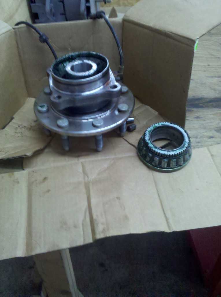

Dunno about your truck but this a bearing failure..... GMT-800 3/4 ton I think it was.... Tire came off.
I heard it was one wild ride too. The wheel came off. On the interstate.
