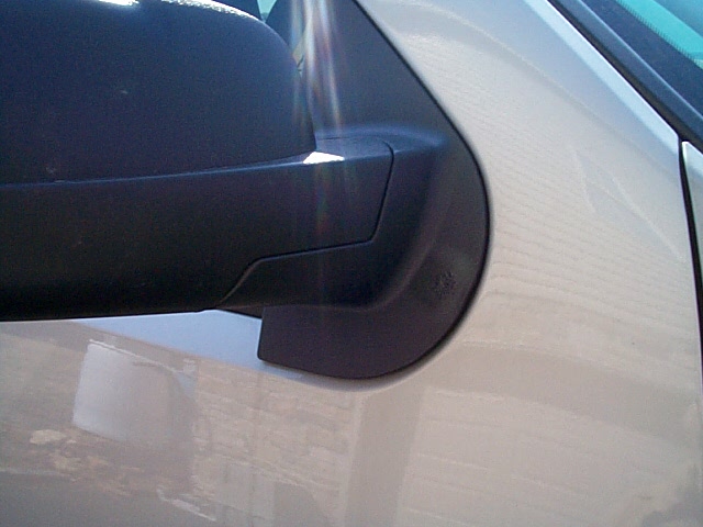

I own a ‘08 Silverado that has the black plastic outside mirrors. Last year both mirrors melted and were replaced by my dealer. He (service manager) seemed to think that the mirrors were vandalized even though there was no apparent method used to burn/melt them. Well it has happened again. The passenger side mirror is melted along the top edge. I remembered seeing a recent segment on the evening news about a Vegas hotel's low e windows causing plastic cups to melt and setting some people's hair on fire due to reflections from the windows. I got to thinking about it and have since concluded that my second floor windows which are above the garage and parking area have the low e glass and, at certain times of the day and year, are reflecting on the mirrors causing them to melt. I keep two other vehicles and a boat in the same area and haven't noticed any problems with them. I'm thinking the mirrors in this truck are being made with inferior plastic. They shouldn't melt from reflected sunlight...should they? Anybody else out there had this problem? Solutions? TIA.

As luck would have it, I found some pictures of the passenger side from the first time it happened.

Uh, yes 4 but the youngest is 28 so I don't think that's an issue. Took pictures of the new mirror and the damage is almost identical to the first. I'm fairly convinced it's due to solar reflection from the low e windows.
that is very strange, but is possible with those mirrors. Looks from the pics that it is just the mirror cap, i wiould just order new caps, hell you can get color matched caps for $60 then i would park somewhere else. but yea, im sorry that kind of crap just sucks
I've never felt that much heat from any window reflection. It's not like it's a parolbolic focused beam or anything. And low-e windows aren't mirrored or anything.....
That looks like someone took a propane torch to them (or heatgun). Does it looked burnt or just melted?
