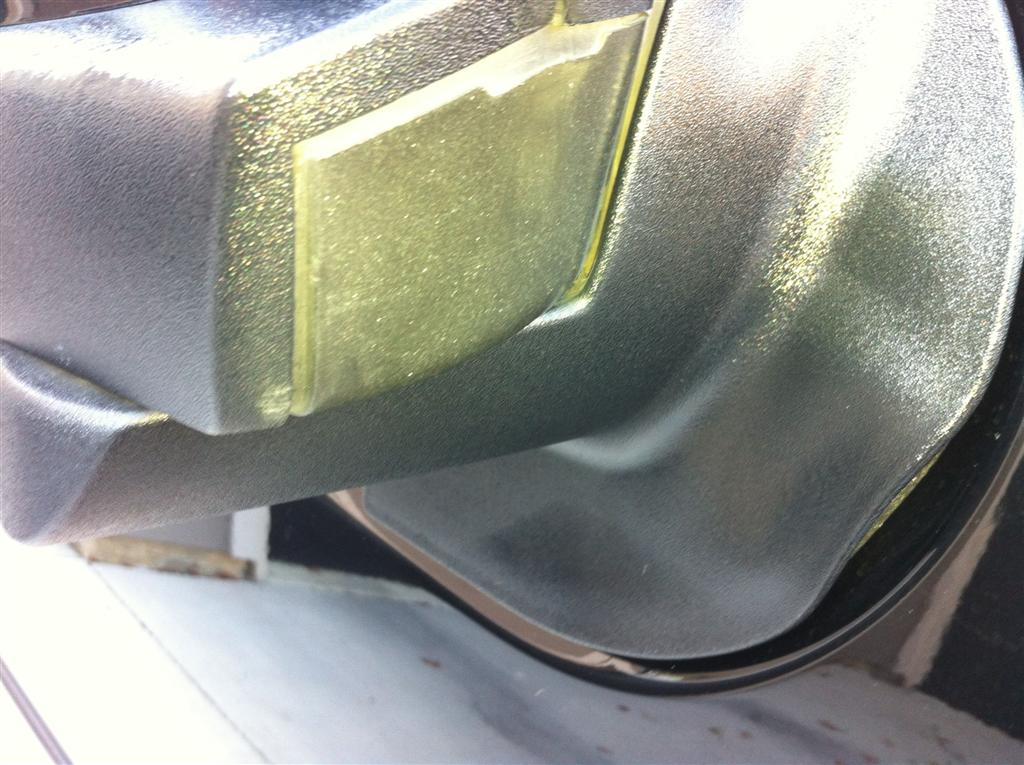

Melting Mirrors

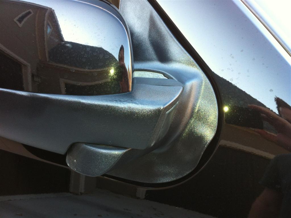

that is very strange, but is possible with those mirrors. Looks from the pics that it is just the mirror cap, i wiould just order new caps, hell you can get color matched caps for $60 then i would park somewhere else. but yea, im sorry that kind of crap just sucks
Get the chrome ones and reflect that reflected energy back to where it came from. If it is truly coming from some reflection, the owner of the house should have his insurance pay for damages.

After doing some research I contacted the National Association of Home Builders and this was their reply:
Dear Mr. ---------,
Reflected sunlight from low-e windows can, if certain atmospheric conditions are present, potentially generate sufficient heat to thermally distort vinyl siding and plastic products, such as your truck mirrors.
To avoid repeat damage, and assuming that you do not wish to replace your windows, you could park your truck in another location, place covers over your mirrors when parked, or install screens or awnings on the windows to diffuse or block the reflected sunlight.
Best regards,

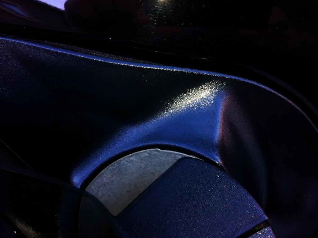

I had a similar meltdown on my old '03 Silverado. The meltdown was along the upper/front edge of the plastic attached to the door, and was IN FRONT of the mirror, so no chance it was the mirror or any window concentrating the sunlight. removed to examine, and no hot wires or anything of that nature behind the plastic in that area.
Dealer shrugged shoulders and replaced under warrantee.

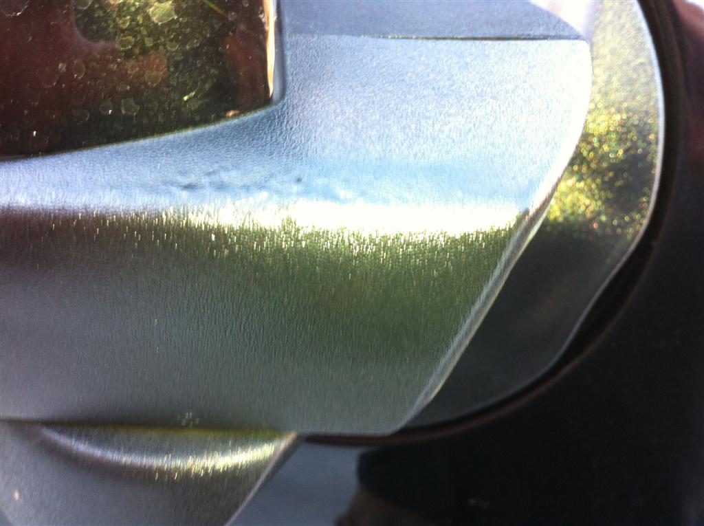

That is interesting. I don't know what the mirror covers are made of but if it is ABS, the melting point is only 221F. However that is still enough to inflict serious burns. If low e windows can actually do this, I smell a big time class action suit in the works. :smash:
I have experience and some training with window coatings. A reflection from windows can not cause damage to plastic like this. It's no more powerful than the sun it's self. put a thermometer in the reflection next time it happens. do you have Heated mirrors?

If you have experienced melting (deformed) mirrors please post your experience and pictures if you have them. I have a 2008 GMC sierra that has melted mirrors. Both mirrors have deformed with he passenger side being the worst.
I like others considered something causing this other than simple exposure to sunlight and haven't found any possible factor other than direct sunlight. My truck is not parked in a situation that wold be exposed to concentrated sunlight reflections from windows.
That is just nuts :nonod: If its not the heat from the sun or it being reflecting off of something than it must be poor quality plastic in some cases. Theres no way its caused from the heated mirrors or the pwr folding mirrors the wires are no where near the melted or deformed part.WOW!!!
