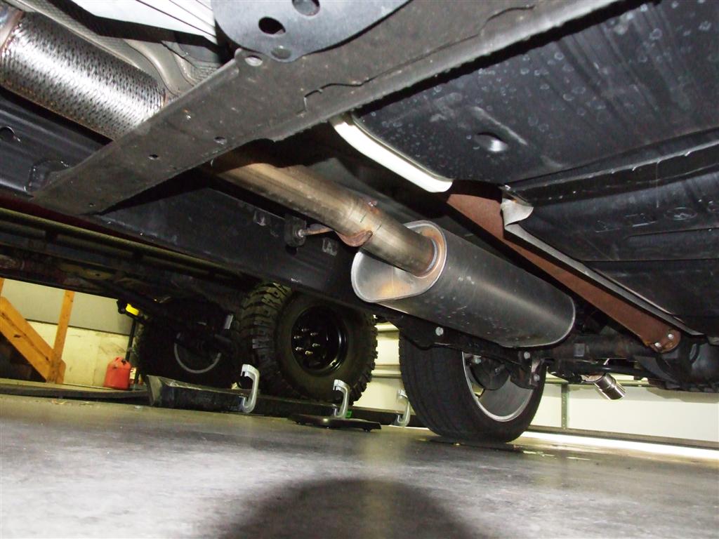

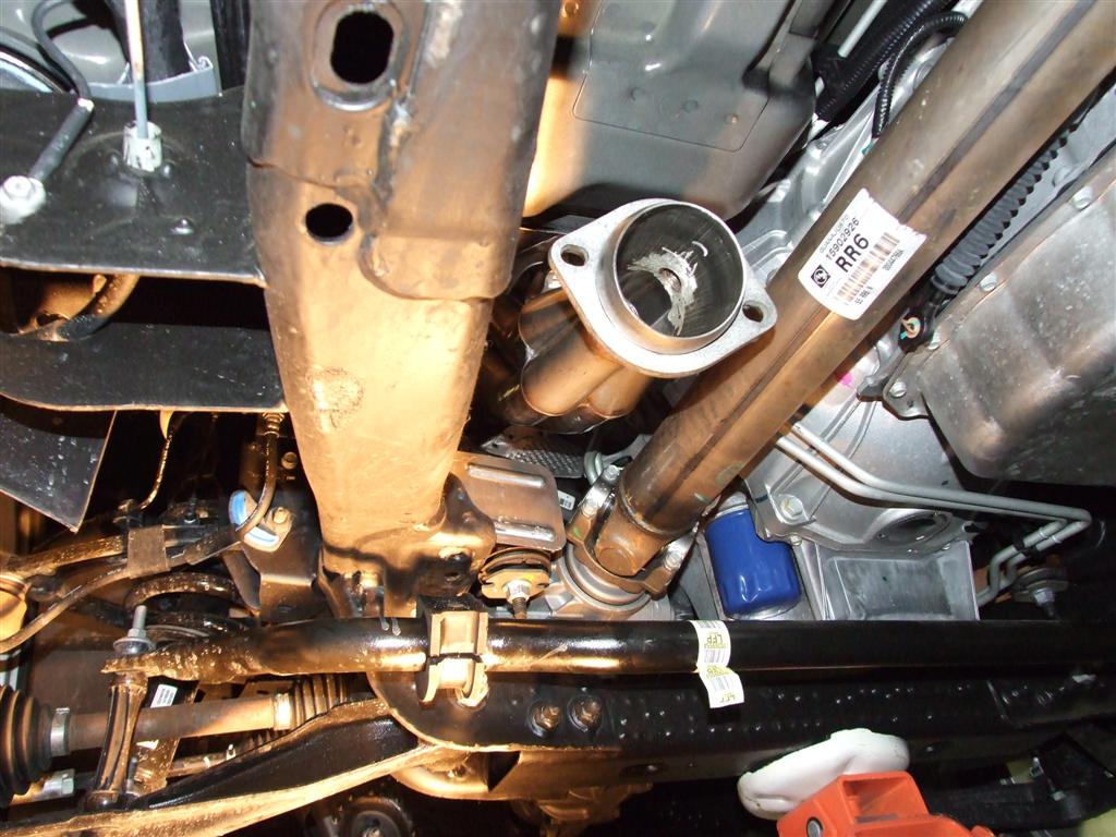

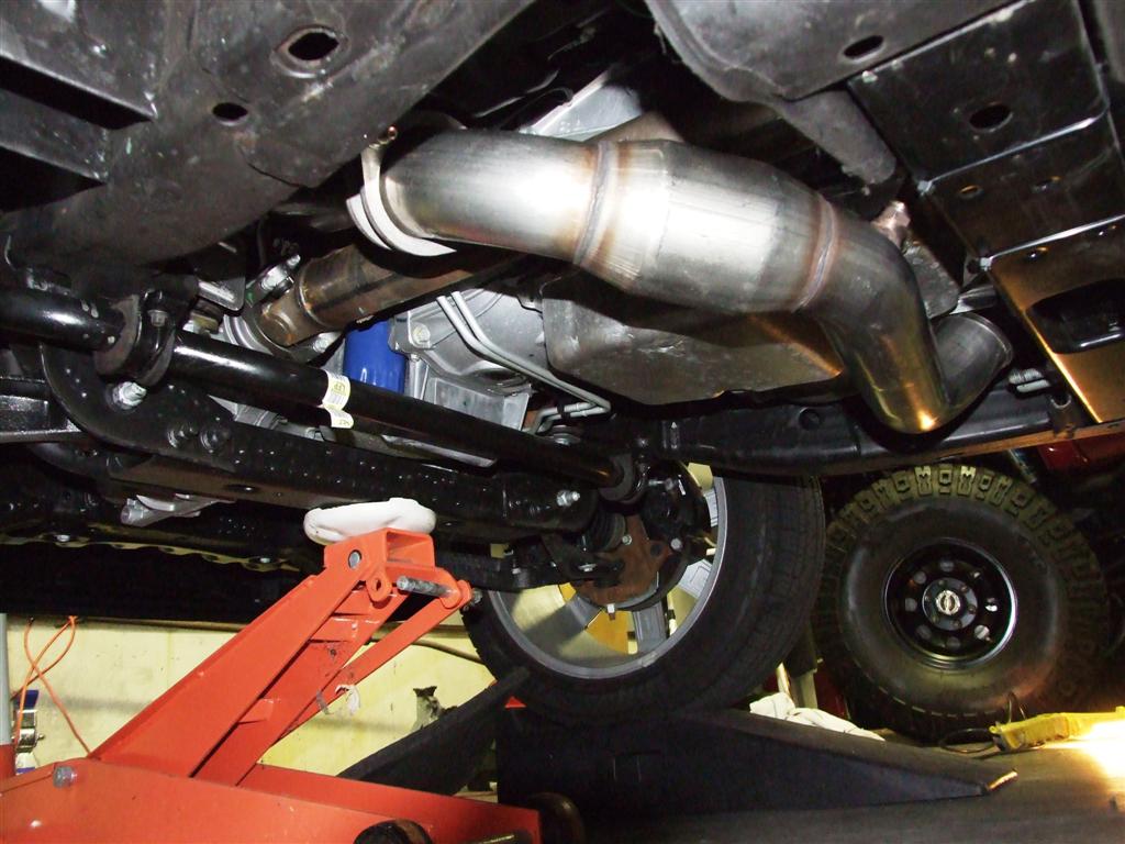

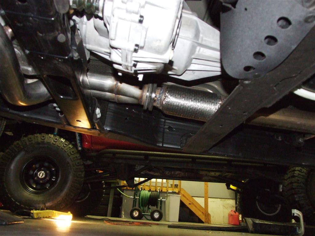

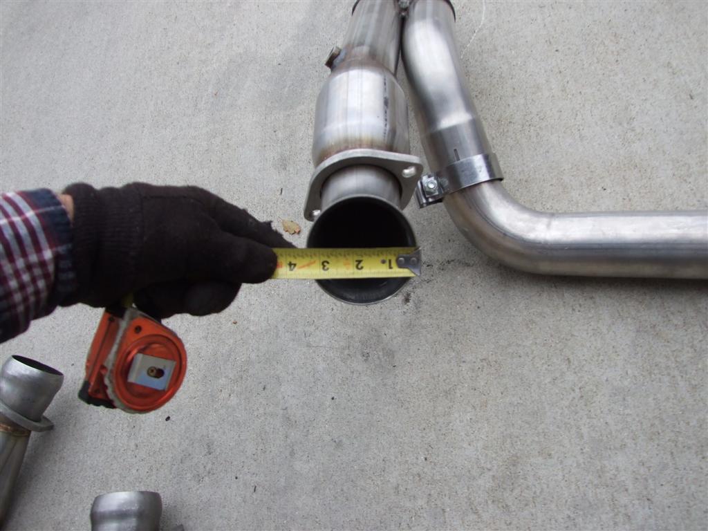

I finally got around to installing the excellent American Racing long tube headers onto my 2010 Escalade EXT. The installation took two days where I spent about 4-5 hours each day on the project and worked at a slower more methodical pace. It could easily be done in one long day with a lift and perhaps a friend helping. I ran into a delay when one of the exhaust manifold to Y-pipe nuts refused to loosen, requiring me to saw the Y-pipe up into sections for removal. I was surprised by that since my truck only had 800 miles on the odometer when I did the install!
I would say the job ranges from easy to moderately difficult depending on your mechanical prowess, tools, and work area.

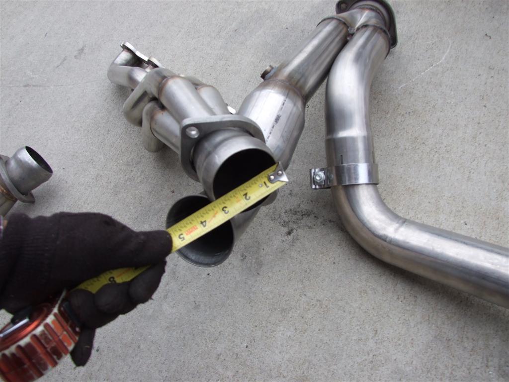

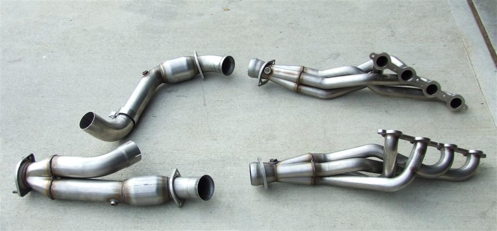

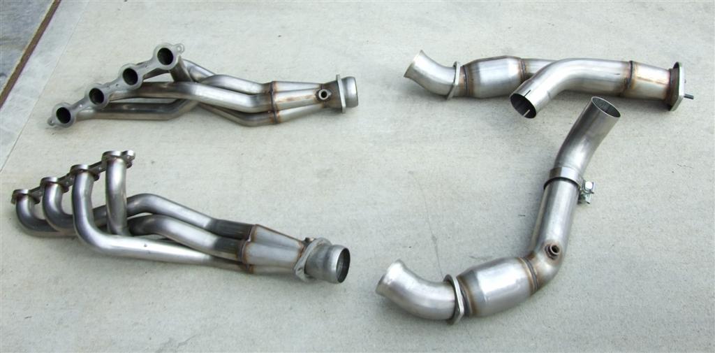

Here's the AR Headers and Y-Pipe all shiney and new!

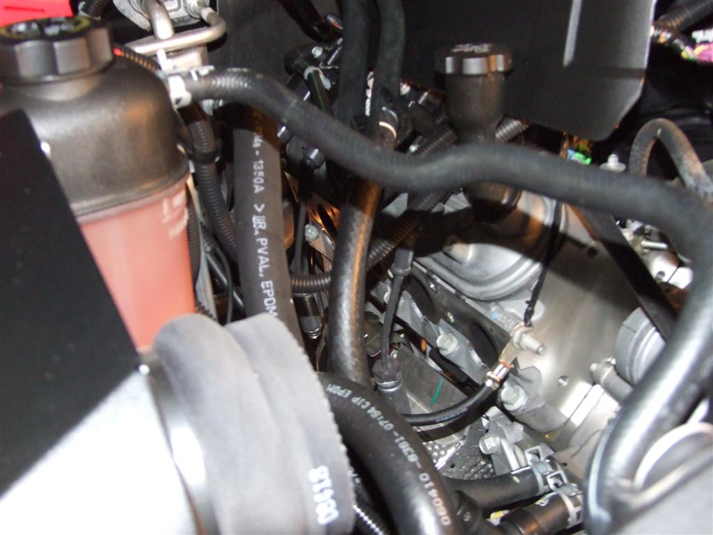

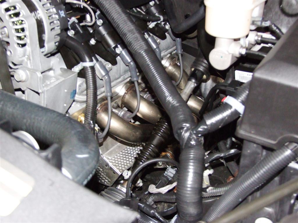

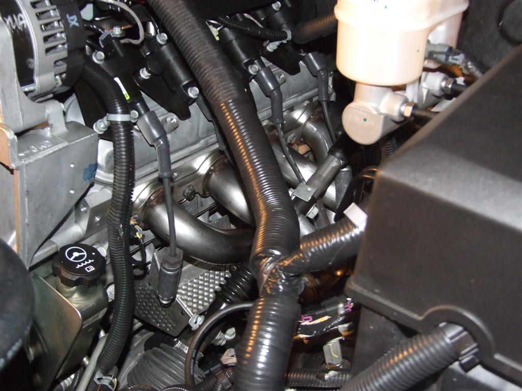

View from top showing everything hooked back up and ready to start

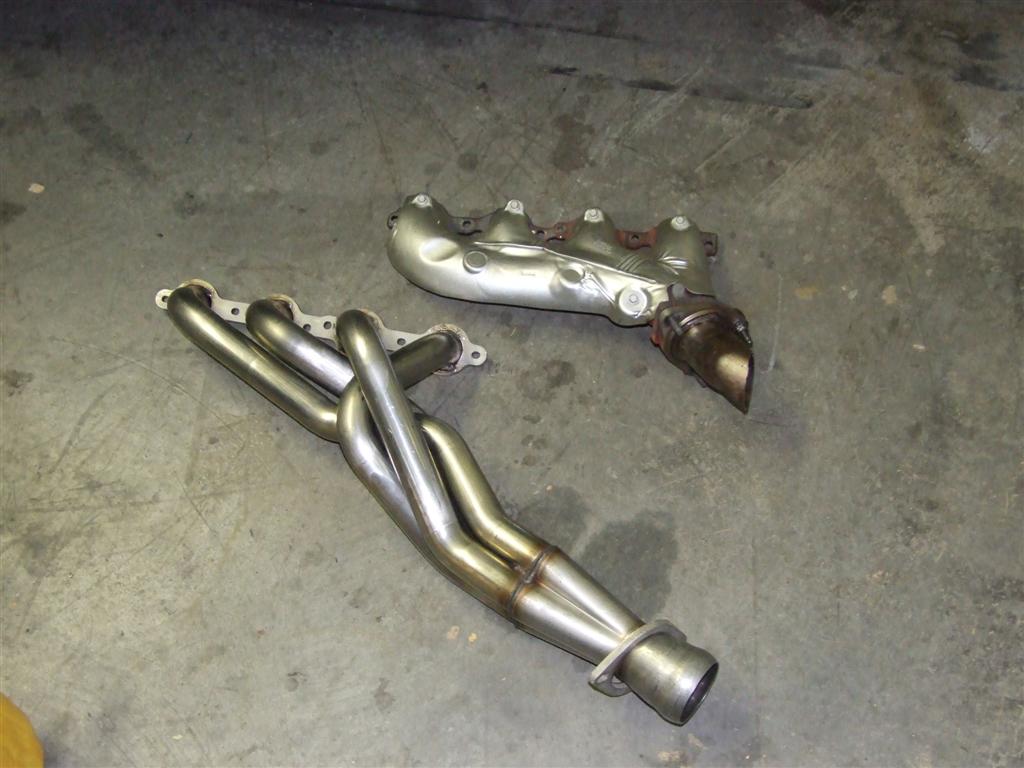

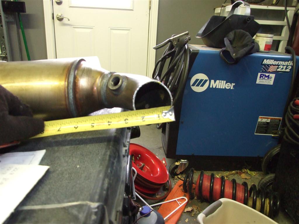

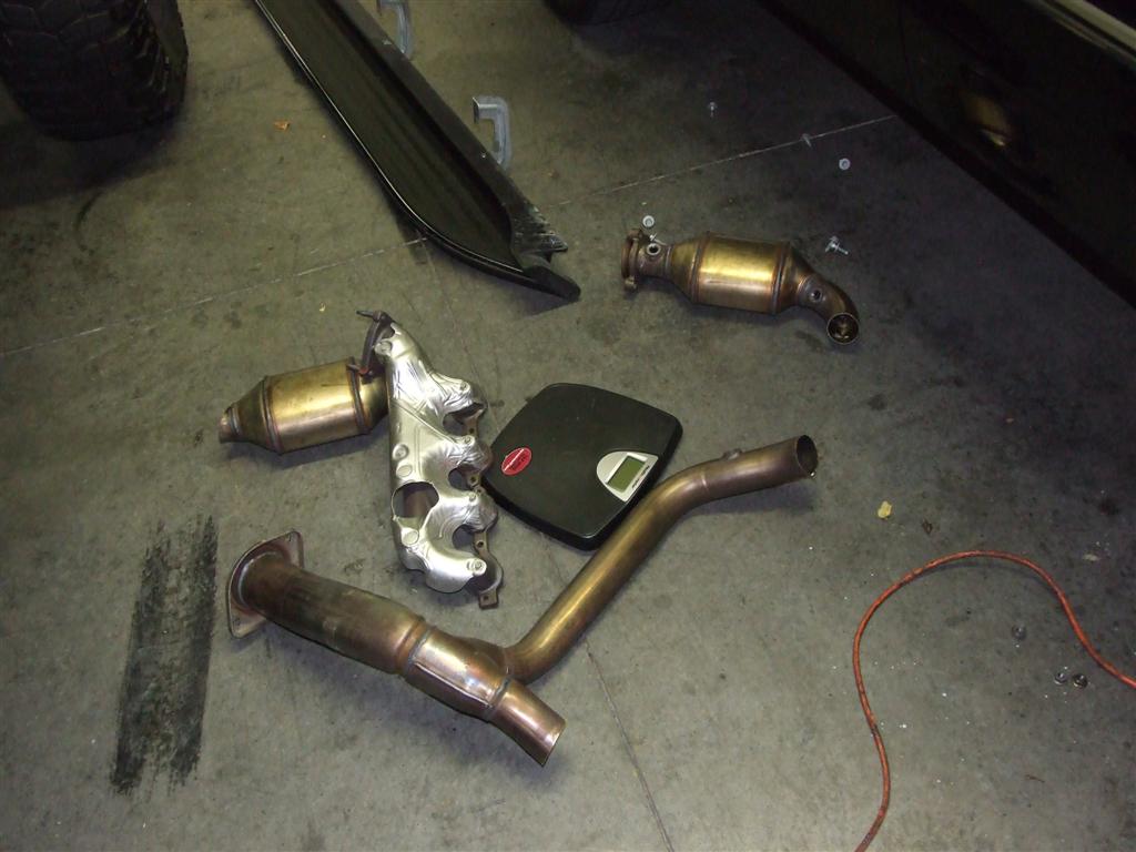

One final comment is that the new AR headers weighed 16.4 pounds less than the factory system they replaced. Along with the factory running boards I also removed while under the truck which were 44 pounds total, I shaved a sweet 60 pounds off the hefty Esky.
