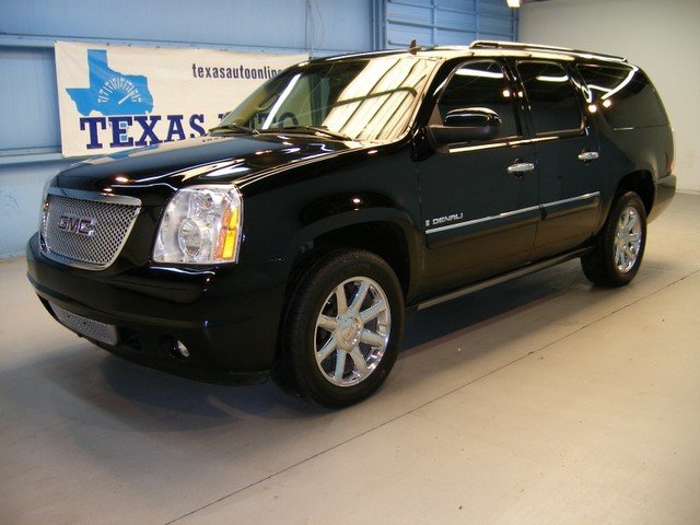

Has anyone installed the OEM/factory version of the power articulating running boards to a Yukon/Tahoe/Suburban/Denali XL/Escalade?? I am trying to figure out how to install on my 2011, currently with the factory fixed running boards. If so, can you also install the defeat switch on the center console? I'm only looking for the Factory version of the articulating step with the chrome insert as shown in the picture below.

Do you have the boards are or you trying to find them? If you are just installing, it will be a PITA running all the wires, but doable. I'm not to sure how they are powered, but you may have to make your own harness or may have to have some programming done at the dealer.

The dealer is installing the boards, and they have ordered them with the controller from the factory. Apparently, the boards are manufactured by AMP Research, but subcontracted to Magna to modify the boards and fit them for GM vehicles in the factory. I haven't heard of anyone doing this outside of the factory, so I am trying to get as much information as possible. I've seen parts numbers and prices for most of the parts including the defeat switch located on the center instrument panel (below HVAC controls and between the power outlets with the foot pedal, Stabilitrak, and Parking controls). I'm hoping it isn't much more difficult than installing aftermarket boards.
Before anyone asks, the factory boards have the chrome strip and integrate much better in that space below the doors, creating the lower valence. Much cleaner look IMHO.
