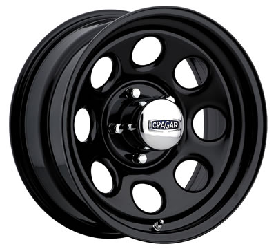

Taking my 2008 Yukon Denali XL to Colombia and I'd like to leave my 20 inch stockers here and change over to 17's with a more off-road friendly tire that will still be at home on the highways down there. 99% on road, maybe 1 percent off road but want the ability if I need it.
So - I'm looking at the Cragar Soft 8 in size 17X8 but I am totally unsure as to what "offset" to get. I know stock 17's on this truck are 17X7.5 with a 31MM offset... What offset should I get with an 17X8? Origionally looking at the GM 17 inch black steelies - but they are too hard to find and too expensive...
