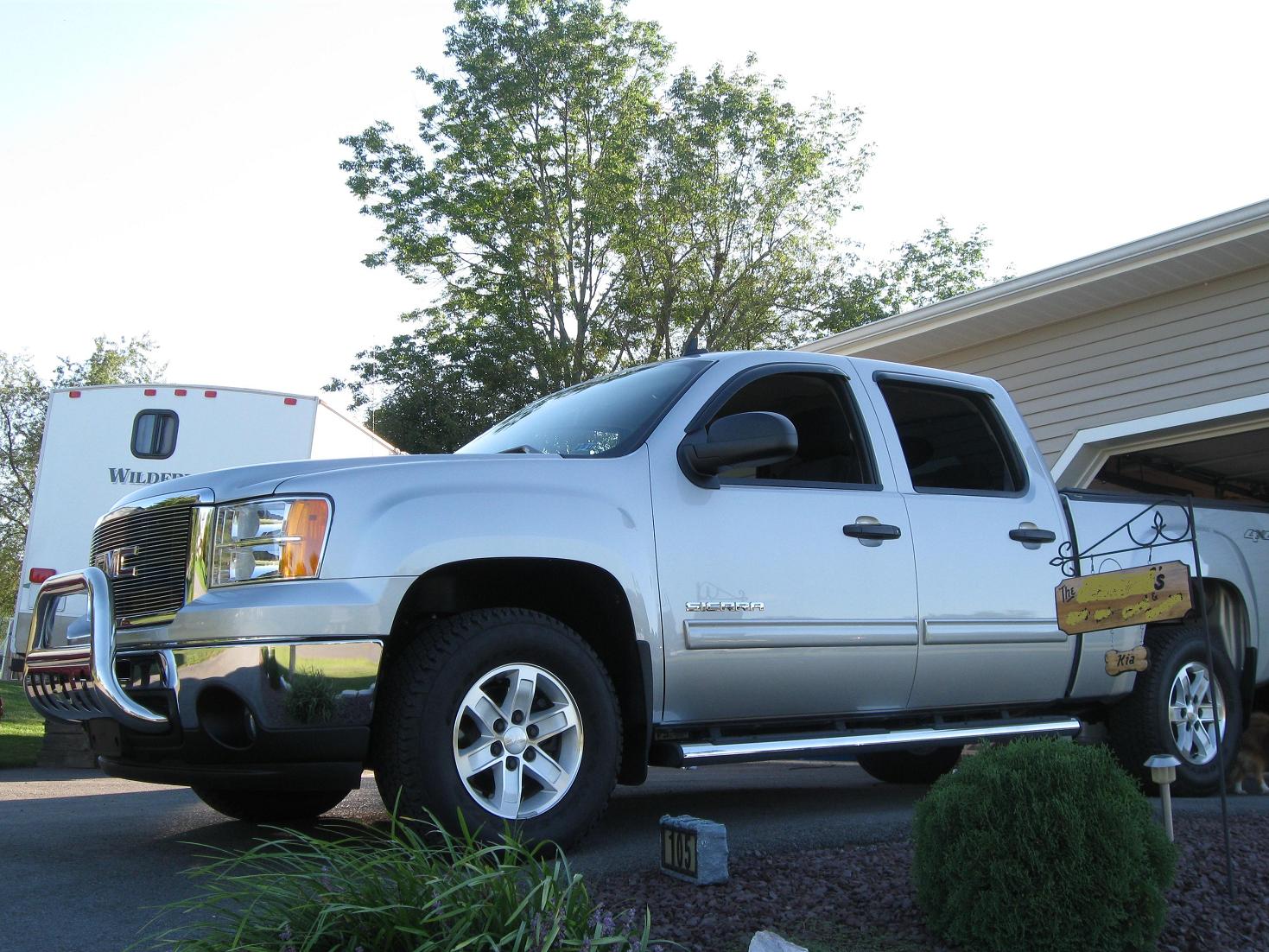

Wel I can give you some insight from personal experience. First of all I have a 2008 Wilderness 31ft TT dry weight of 6,300lbs. So I have about the same weight. When I bought it I had a 05 silverado crew z71 wtih 5.3 and 3.42's. It was rated to pull 7.500 lbs and let me tell you the 3.42's with the 4 speed was not a good combination. I traded it on a 09 Silverado wtih 5.3 and 3.42's, but 6 speed and heavy duty trailering. It was rated to pull 9,500lbs. This combination worked ok. The truck definately knew it was back there but it handled it. I also added Firestone ride rite air bags. Wow they made a huge difference. Great stability, no bounce,,Highly recommended......Anyway we were going to get a bigger RV which was 2k heavier. So told wife we should upgrade to a 2500 with the 6.0, well didnt want the 4.10's becaseu of fuel, then realized I could get a 6.2 with Max trailering in the sierra, 3.73's..........Im here to tell yah that 6.2 is a beast! It pulls like crazy and along with the 6 speed. Very happy.. Fuel mileage difference between my 09 and 10,,,,very little difference. about 1 to 1.5 mpg.... So to answer your question. The 5.3 will handle it fine with the 6 speed as mine did.....BUT>>>>> the 6.2 rocks.... Hope this helps.......
And for the record my wife changed her mind on getting the bigger camper so now Im stuck with this AWESOME 6.2!!!!!! yee haa!!!! :)
