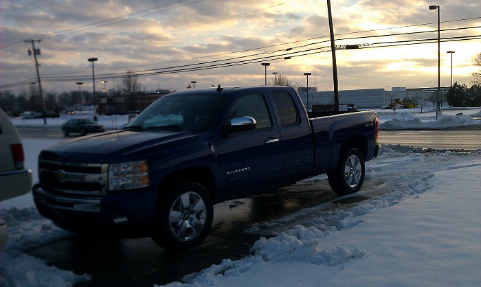

tires are 305 35 24s they come with srry or a 295-35-24 i think thats to thin of a tire?
i want a set of the u2 55s 24s everything stock on my truck well they rub alot i need help asap how bad well my ride be i got stock 20"s with goodyear ls tire's well they stick out a lot from my fender i know this been asked i cant find no topics
