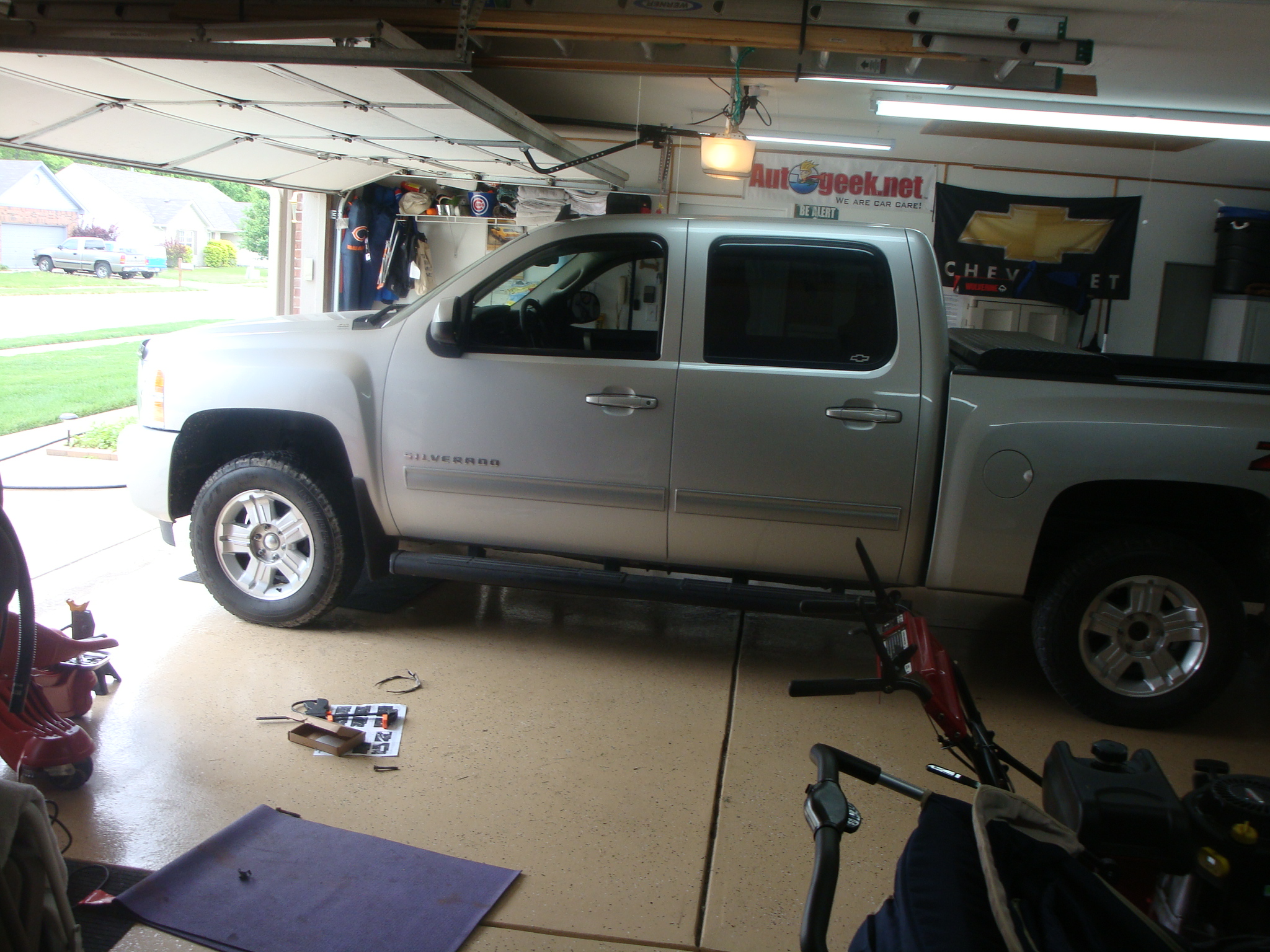

Well in the next few wks I am going to add the 2" RC front leveling kit and 3" rear blocks. Here are my before measurements on my 2010 Crewcab 4wd Z71 for comparisons sakes after install
This is from the garage floor to the bottom of the fender (in the middle)
Front Drivers Side: 36-5/8"
Rear Drivers Side: 38"
Front Pass Side: 36-7/8"
Rear Pass Side: 38-3/8"
I will post after measurements once I install.

Got it all installed today (RC 2" front level and zone offroad 3" rear blocks)
BEFORE
Ground to top of front bumper: 26-1/4"
AFTER
Front Drivers Side: 38-15/16""
Rear Drivers Side: 39-7/8"
Front Pass Side: 39"
Rear Pass Side: 40"
Ground to top of front bumper: 29"

Ok so you gained one inch in the rear? Is it because the blocks in there already are 2 inch? This looks good! I like it, might do it myself!
Increase: 1-7/8" (1.875")
Rear Pass Side: 40"
Increase: 1-5/8" (1.625")
Seems like more than 1" to me. I believe the stock blocks are 1.25" so the numbers I see are reasonable.

Opps you're right, thanks.
I understand I did a quick look right off the bat and was like WTF it barely changed then I readjusted my eyes and seen it was more. I can also tell a difference in how high the bed sides are. Doesnt bother me as I dont load things in and out over the sides.
