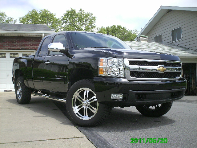

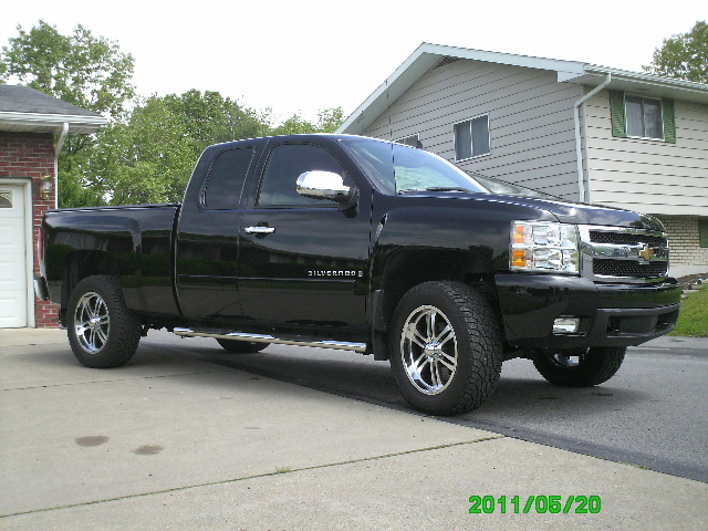

Would i be able to run a 33x12.50 without having to cut any metal? Also if anyone is running this set up and 33's please post pics anxious to know how it would look. Thanks for the help.
Is your truck 2 wheel drive or 4?
I' running the RC level with the 1.25 body lift with 275/60/20(33x11) on 20x8.5 wheels with +25 offset. No rubbing No trimming
A few pics
post-76283-1306078491_thumb.jpgpost-76283-1306078467_thumb.jpgpost-76283-1306078438_thumb.jpg
Denverk16 you truck looks great. With your set up the stock wheel and offset would work. Would you think that a 1.5" leveling kit with the RC 1.25" BL clear 33's 275/60/r20's? I have looked all over for this combo and have not seen one. Everyone is running a 2" leveling kit with either a 1.25" or 1.5" BL.
Seems like the 2" leveling kit & 1.25" is a nice mild look that results in a very nice stance.
Most people run 275/60/20 with only a 2" leveling kit on stock wheels. You should have no problem with 1.5" leveling kit and a body lift.
I clear them with 2"
