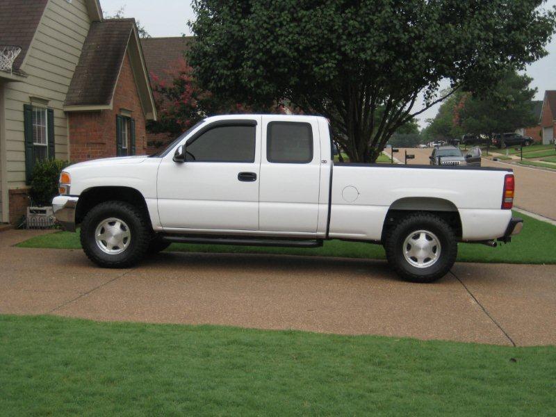

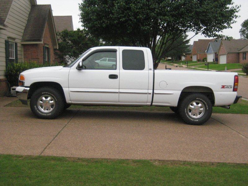

Before
After

Gently pry the mouldings off with a plastic trim tool ( heat may help) then use a rubber eraser wheel and a drill to remove the adhesive. Careful not to stay in one spot too long and damage paint. for the stickers use a heat gun and try and get an edge too lift by using a PLASTIC razor blade then peel the rest off.
I did exactly what GMTech686 said and had no issues, very easy.
Before
After
Personally I thought your truck looked great in the before pic! To each his own I guess. :dunno:
Before
After
Personally I thought your truck looked great in the before pic! To each his own I guess. :thumbs:
I appreciate it. I just didn't like all the chrome that was on it at the time. Before I took the first picture, I had already removed a chrome toolbox and some diamond plated chrome bed caps that were all bent up. I felt like it was a little too "grandpawish" looking.
