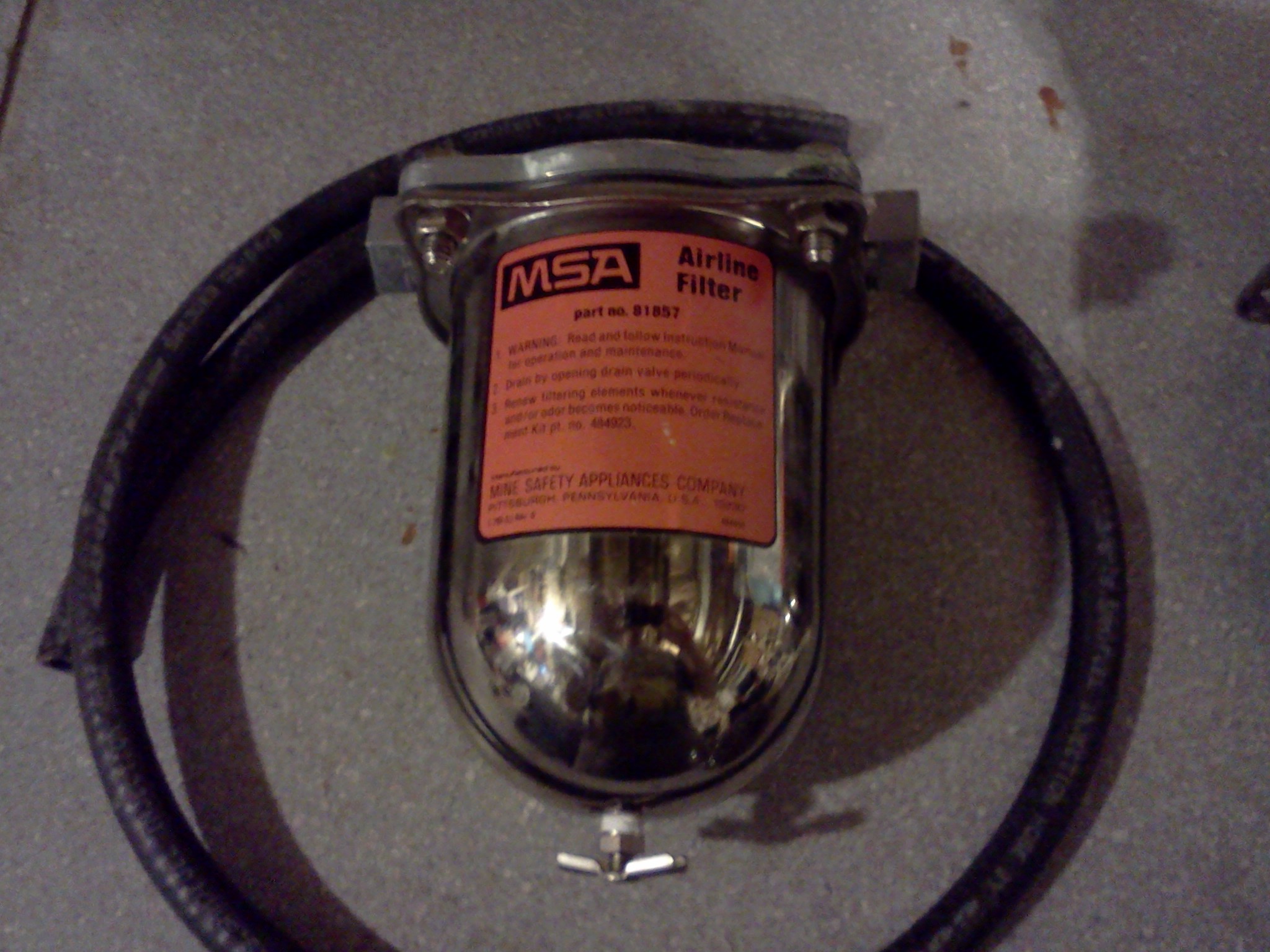

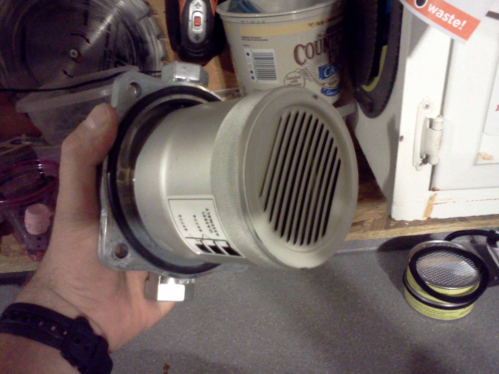

Well lets see, how these photos upload. So I have been researching the entire PCV oil catch and entertaining if I could build one myself. I figured it would have to have a change of direction for the air flow and something to catch the oil. This is what I came up with. I had a MSA (Mine Safety appliance, CO.) air filter. The filters part number is 81857, I already had one laying around but you can find it on Ebay for around 30 bucks. There website is msanet.com or msanorthamerica.com. The search on google is msa 81857.

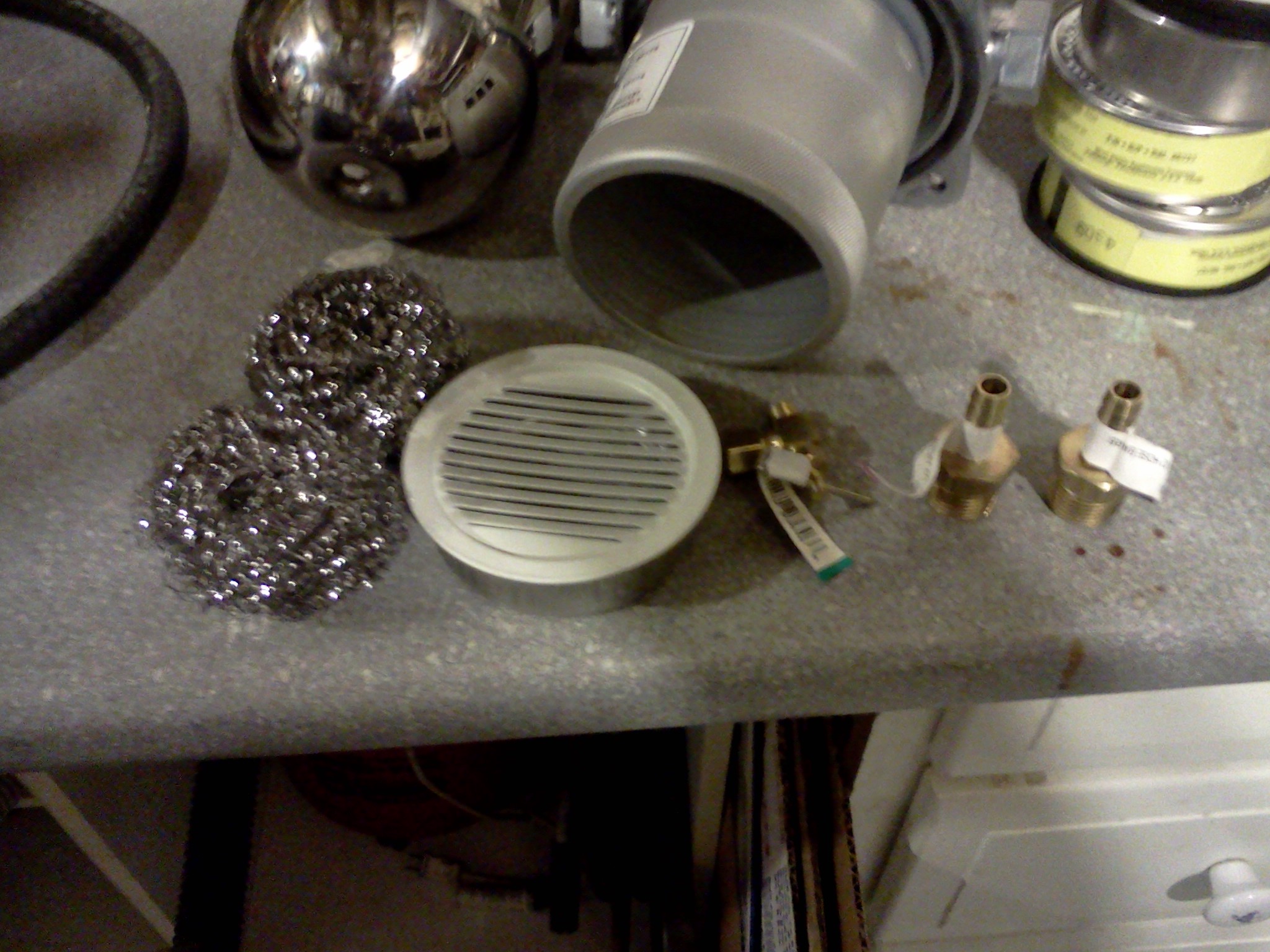

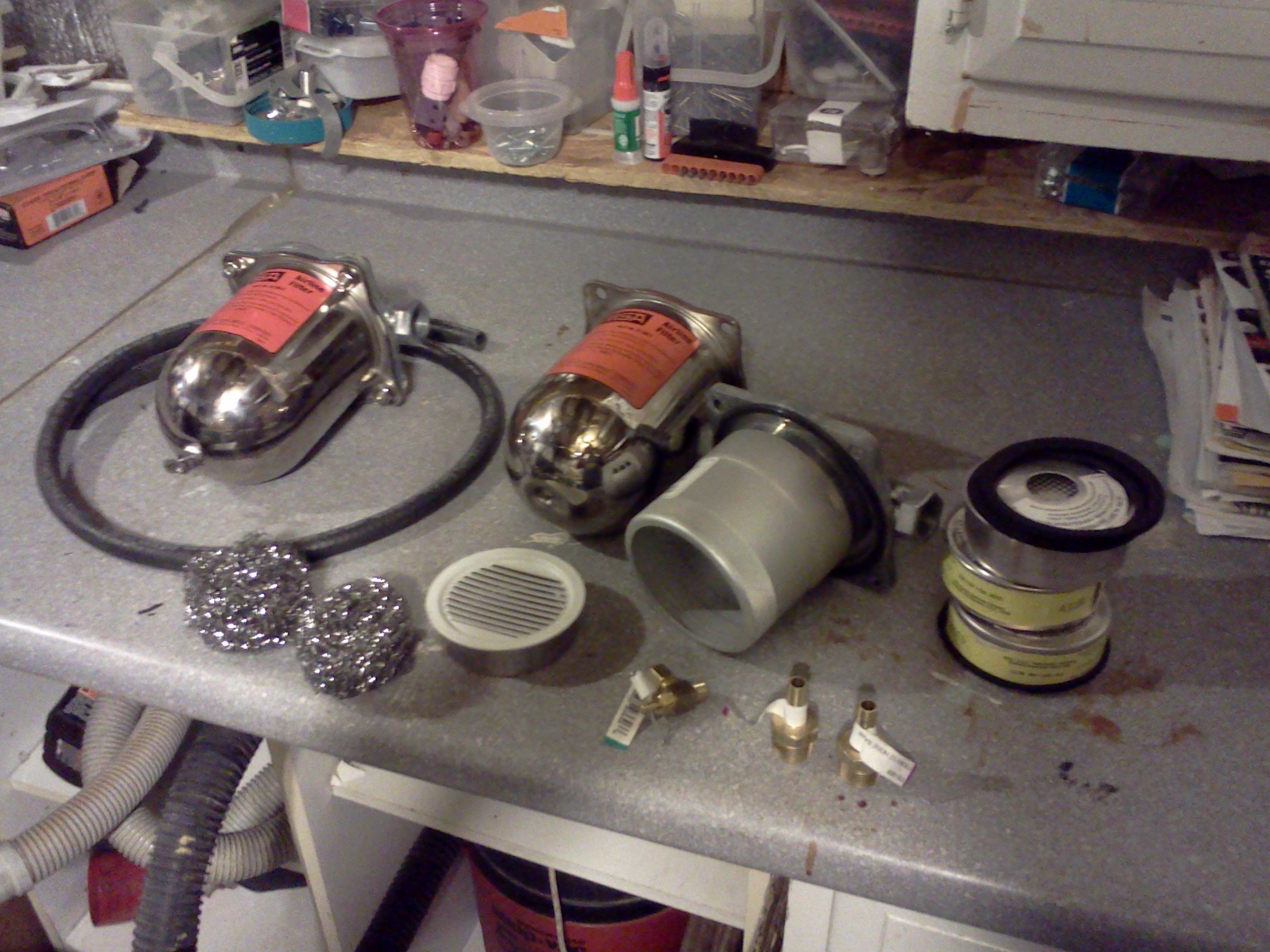

I also got some threaded hose barbs, a round soffit vent for some additional air deflection and some stainless steel scrubby things for the oil to stick too and a needle valve to drain the oil.

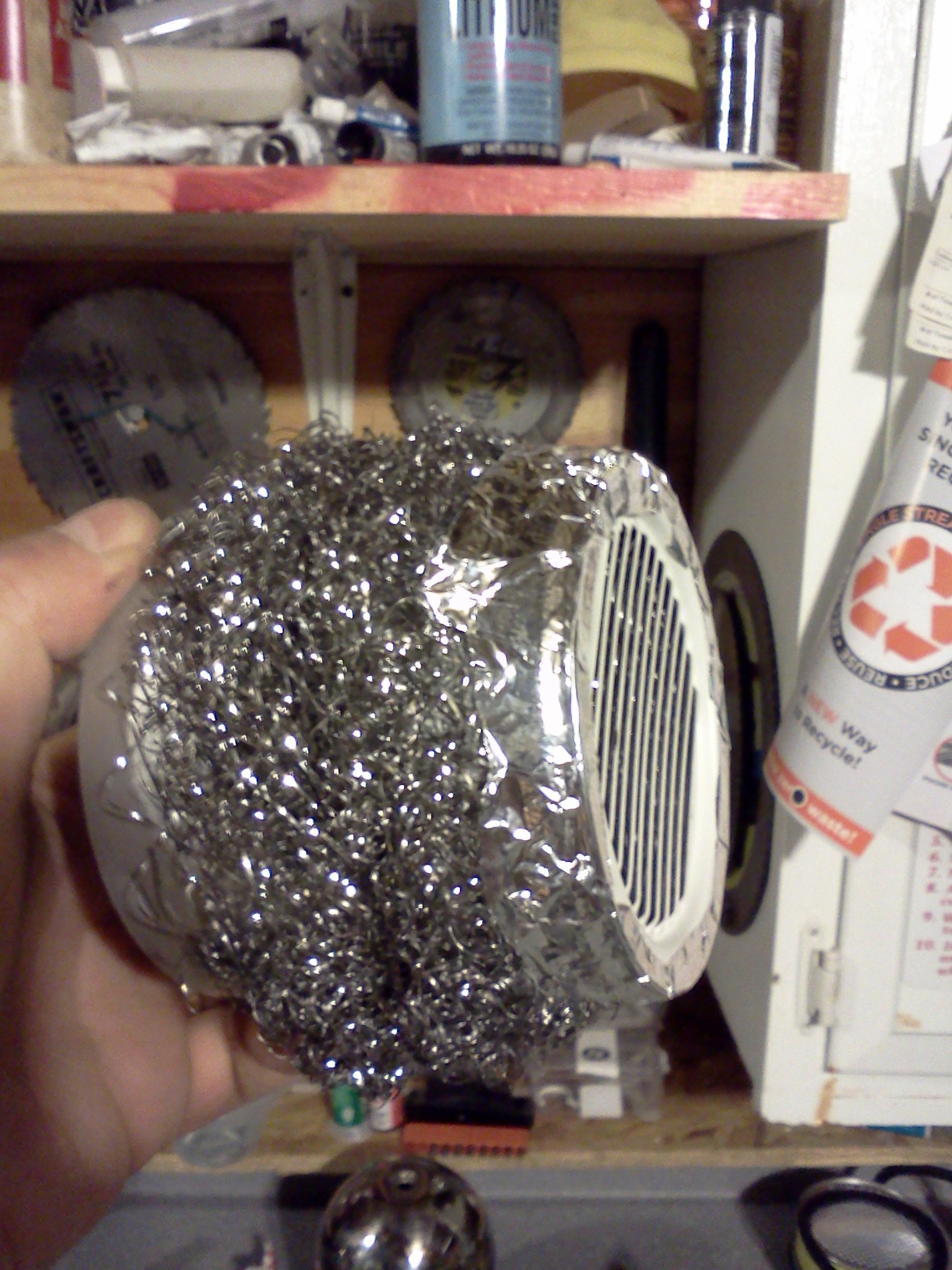

The first thing I did was remove the air filters in the bowl, I left the round thing that the filters mounted in, Wrapped the stainless steel wool stuff around the round thing and glued the soffit vent into the bottom of the round thing, The air flows in around the outside and goes out the inside. It is extrememly free flowing. I will start with this and see if the pic uploads and go from there.

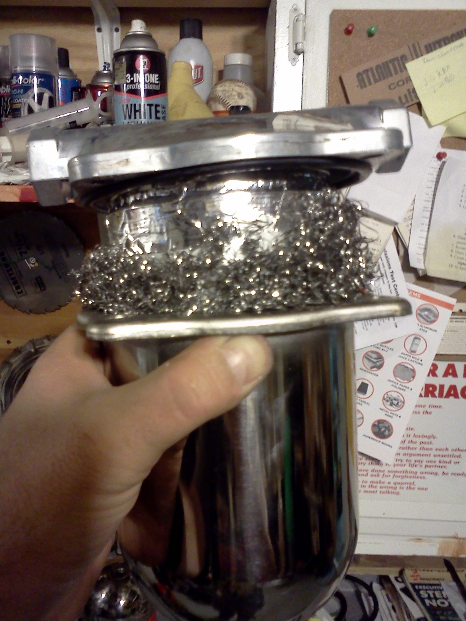

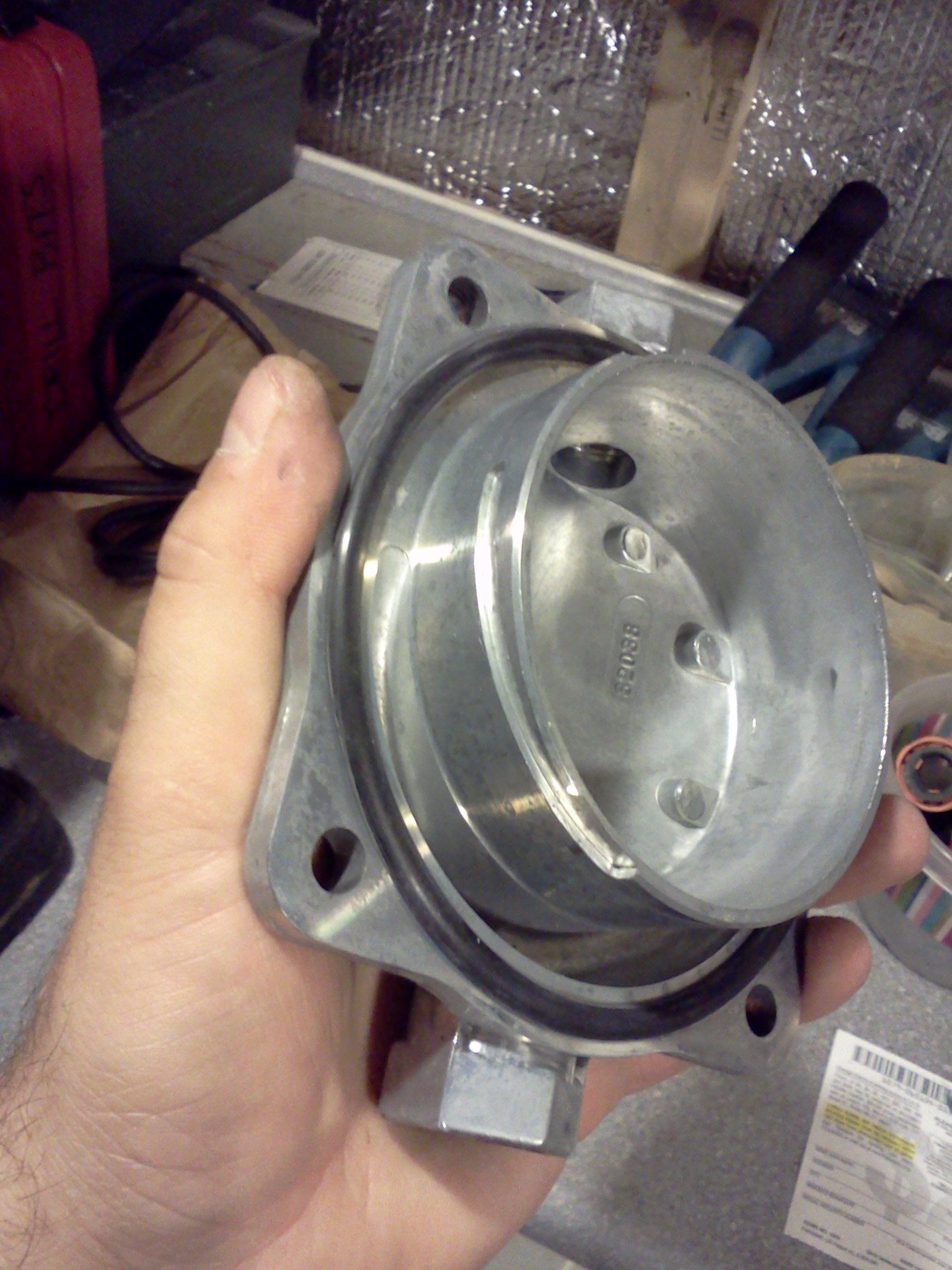

You can see the soffit vent and the bottom of the round thing, I glued the vent to the bottom of the filter holder and then wrapped the stainless steel around that using some mechanics wire to hold it in place
I also put my other stainless steel wool thingy inside the round thing (In the usual use of this filter it holds air filters to allow you to breathe compressed air, the filters go down to (.3microns) They also remove vapors and mists and stuff)) But I think they need to be removed to make this work.

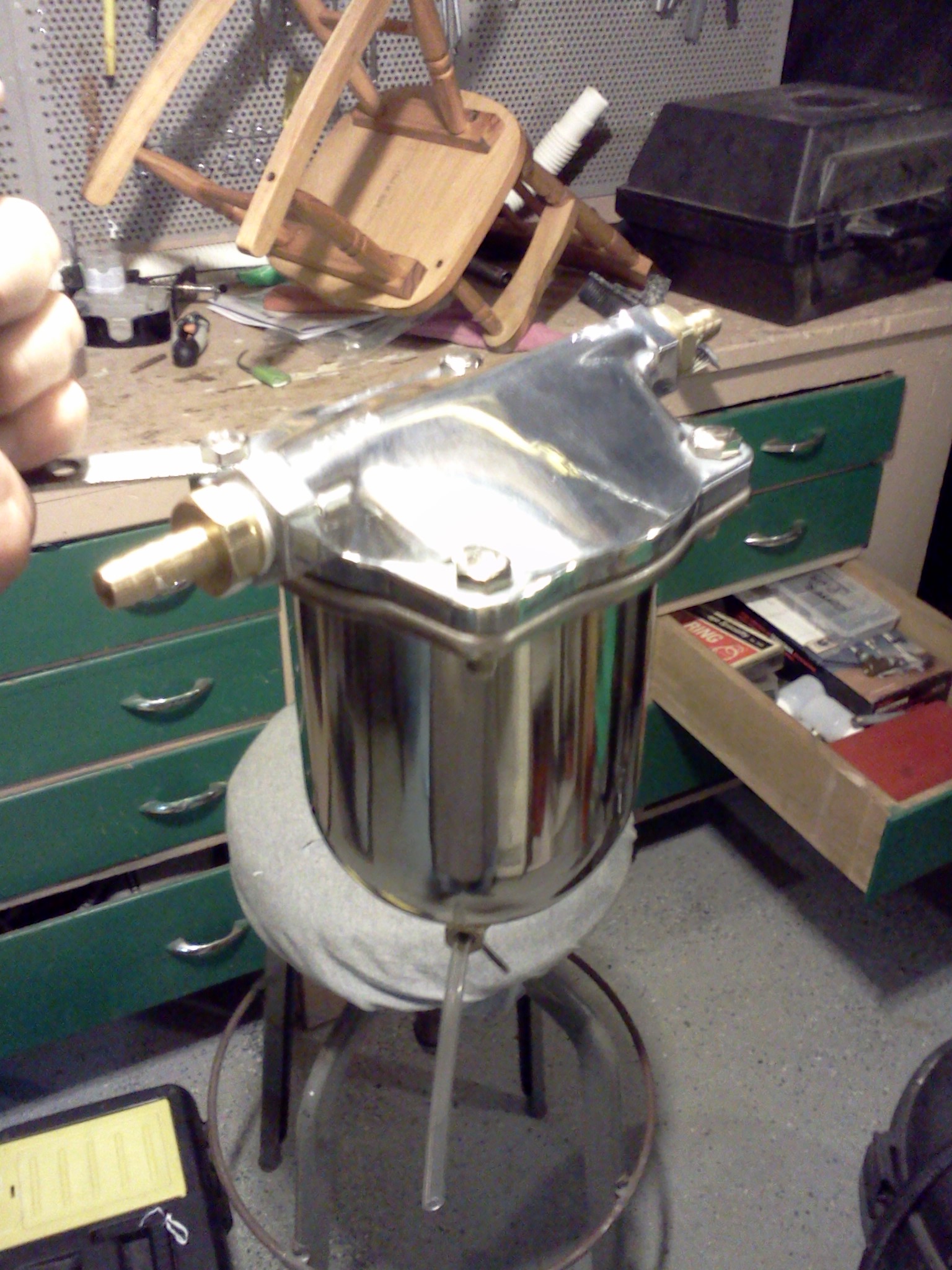

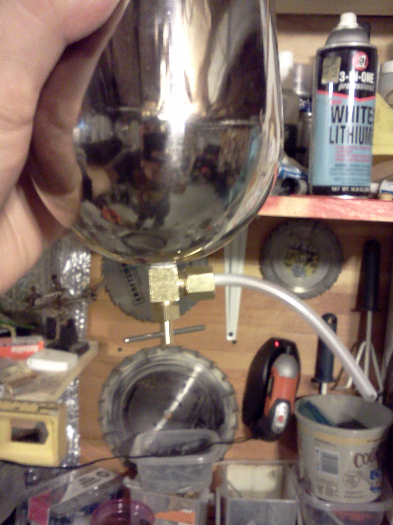

added the needle valve, and started to polish it. The kit came with a petcock but I didnt like that, the needle valve should help with drainage, making it easier. I also started polishing and waxing it

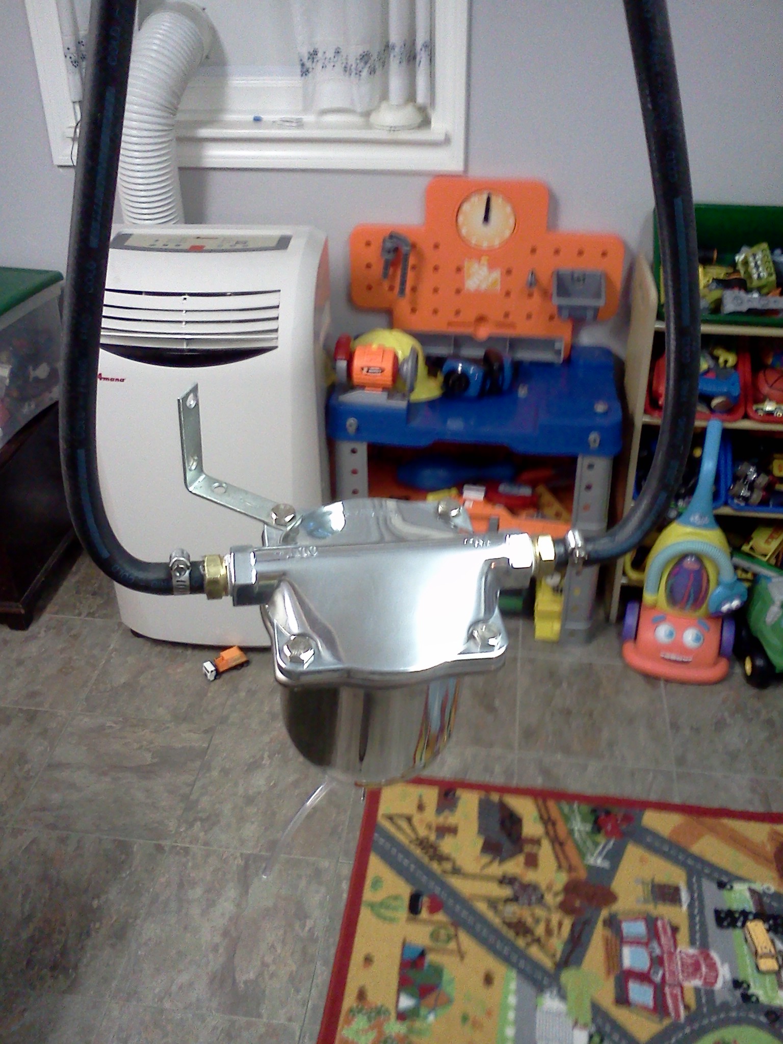

All done, now to find a place to mount it. There are a couple of bolts that have some ground wires under the hood, but it is big and heavy. It doesnt matter its raining out anyway
I am hoping it works, Basically I had the filter laying around so it was 20 bucks in some fitting/SS scouring pad, As i said you can find the filter on ebay for about 30 bucks, becareful though there was one website selling it for 524 bucks.. But for around 50 bucks it is a highly polished, metal, catch can that should work, based on what I have seen it should be better than the air compressor filters that no one seems to like.
