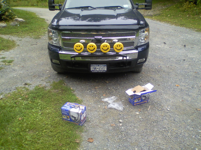

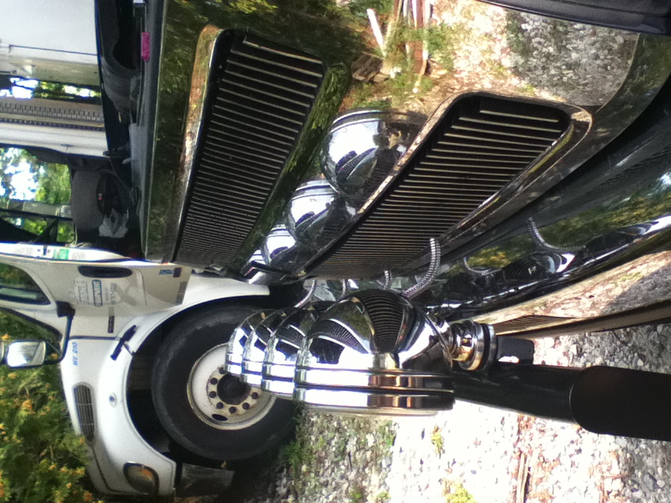

i installed 2 hella 500s in the euro or combo pattern and love them. i am planning on 2 light force long range lights for the center mounts. I used neoprene washers on the top and rubber gasket washers on the bottom of the mounting bolts of my lights. they do not shake a bit going off road and i are easy to adjust and do not move all over the place when driving off road.

Thanks Bones30, decided to get a bull bar. having trouble getting the lights up high enough to shine out further, might need to go with 4" lights.
wired the lights to the overhead factory switch that is part of the plow package... worked great!
Wonder if the KC daylighters work, because they are more of an egg shape and will sit further out from the bar?
