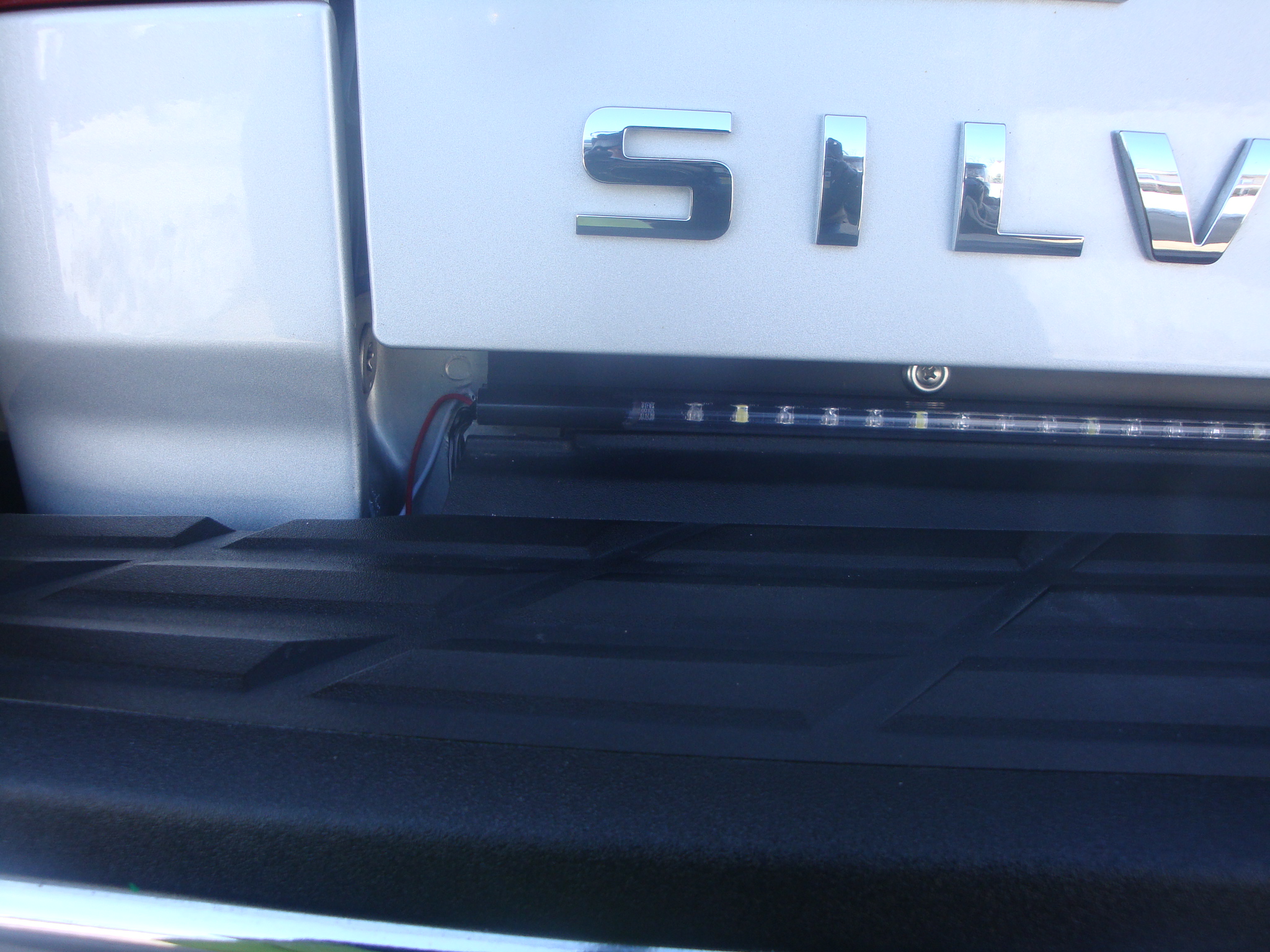

Just bought a Recon 60" Line of Fire LED tailgate light bar. Installed the bar just slightly (1/8") above the black of the bumper, so it can be seen. Problem is, when I put the tailgate back on and lowered it, it jammed solid at about a 45* angle against the LED bar. There is no way that I can go any lower and be seen.
Has anyone else had this issue? Fix?

Any pics would help too, tks.
I don't know what the Recon looks like, but I had the same problem when I put my Plasmaglow Fire & Ice bar on my truck. The PG bar has a small "lip" on the top of the backer piece. I wound up trimming some of the backer piece off to get the tailgate to close without snagging on the bar.
Found this pic of the Recon and it is pretty much like the Plasmaglow bar in how it is constructed.
