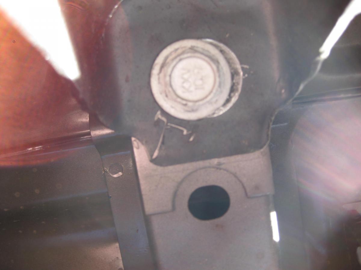

I crawled under the truck this am cause yesterday the noise really ticked me off, this is what I found around the bolts hold the bed on the frame. Ryan could you look at your truck and see if you have similar issue? It looked like the bed is cocked 1/4 inch on the right vs the left. I checked the bolts on the driver side, and they had no marks.
Im going to attach the files instead of making an image.
Chuck
Where did you take the picture at? I can check tomorrow. Truck is in the garage and the floor is all went as it was raning/snowing today
It was taken under the frame where the cab meets the pickup bed.
I found the problem on my truck, it was not the pictured bolts. It turned out to be the Weston Steps on the passenger side. I took everything off, including the brackets. I have driven it 20 miles and its gone. Now I will figure out which one caused the noise. I went to town in the truck last nite with my wife and was really embarrassed at the noise. Terrible. Anyhow its gone and I will find out how to keep it gone including sending an email to Weston.
