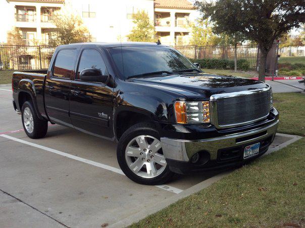

Hey guys, I searched the site for this, but the results came up with nothing. I searched "Denali Front Conversion" and "Denali Conversion" and it came up with no results found. I find that hard to believe. I know people have done it. I had a minor accident with a guard rail after missing Bambi and her friends. After already replacing my two passenger side 20" rims, now I need to fix my bumper, upper valance cover, passenger fender, rear passenger bumper and some passenger rear quarter body work.
I want to go from the chrome bumper to a painted bumper like the Denali's but RockAuto doesn't have one. They only list a chrome bumper, but if I click on Bumper Cover, they have one, but its without a picture so I can't tell if its what I need.
Can anyone point me in the right direction for everything I need? Looking for a Denali primered or black painted front bumper. Is the upper valance different? Does this change the lower plastic pieces below the bumper?
I know what I need to get for the rear. That's simple, I just need the rear bumper end caps that are primered, which I have found.
So I just need to know what I need in order to do a conversion from a Sierra 1500 SLE2 Texas Edition to a Denali front end.
I have a 2008 GMC Sierra 1500 SLE2 Texas Edition.

All you need to do is have your local favorite paint shop bead blast your current bumper and color match it. Buy the upper and lower grills and install chrome hooks. I chose the route of a hybrid look between the two
Denali Grill with SS Toe hooks
I chose not to install the lower grill. :thumbs:

Thanks for the reply, but I don't really see how it's any different than what my truck looks like. So I would need to bead blast a new chrome bumper to take the chrome off, then have it primed, prepped, and painted? Seems a bit extreme. If that's the case, then how to actual Denali owners fix their front end damage to have a color matched bumper? The Denali bumper should be a direct bolt on as I dont think there is any difference between the two, just one is chrome, the other is painted to match

I converted my 09 GMC to a Denali front end when it was brand new. You need a Denali chrome grille, a Denali chrome lower grille AND a Denali lower valance. The lower Denali grille will absolutely not fit in a standand pick up lower valance.
I sanded the texture off the Denali lower valance and had it color matched to my red truck, then you must paint the area behind where the lower grille goes flat black. If you don't, the lower grille just looks like an "add on", not like air actually flows through it.
I left my bumper chrome and it makes the truck look bigger, like this massive chrome wall coming at you. Denali owners always do a double take and wonder why my "Denali" looks mean, while theirs look tame.
I have the GMC chrome grille with the bumper off a Denali painted to match my truck. The bumper was a factory gm bumper and it bolted right on my 2007 Sierra SLE2 It matches right up to the upper and lower.
