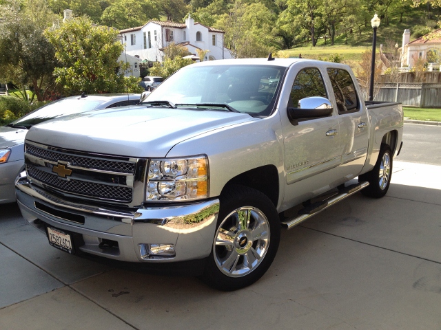

post-112905-0-09372300-1333904990_thumb.jpgI bought a 2012 Silverado about 5 weeks ago and ordered all the parts referenced here and installed them and can't get the transmitter to work.
I have a security gate with a rolling code in my neighborhood, which is why I swapped out the LEar for the Homelink. I never tried the Lear, so maybe I will go back to that just to make sure that works since the instructions are in my owner's manual.
Does anyone know the programming instructions for the Homelink? I tried following the instructions in my girlfriend's cadillac SRX, which we were able to program to open the security gate just fine using the existing remote.
Thanks!
One other detail - the truck did not come with any opener installed. I ordered the whole console w/ lear opener, homelink transmitter from ebay, and the buttons to fit the homelink.
