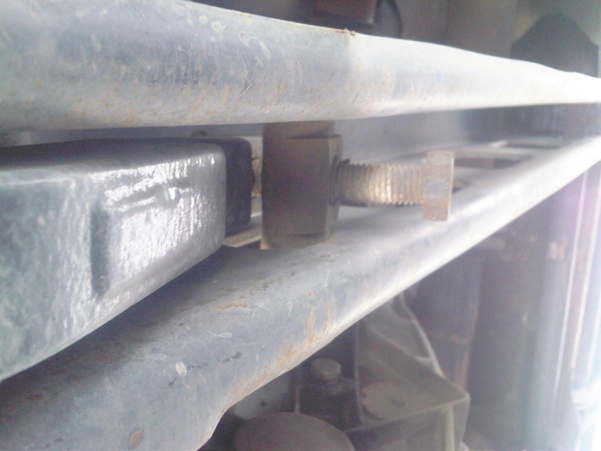

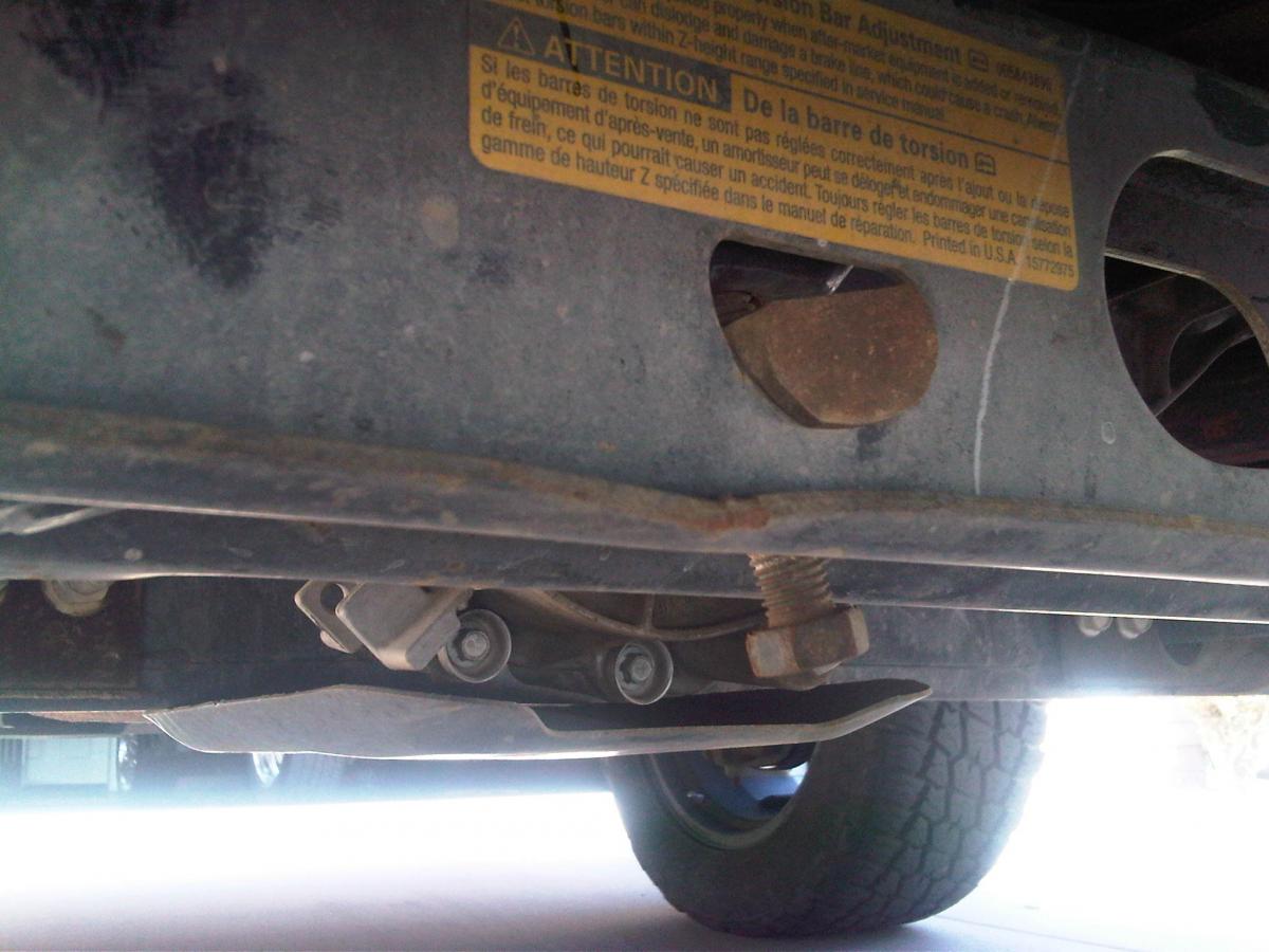

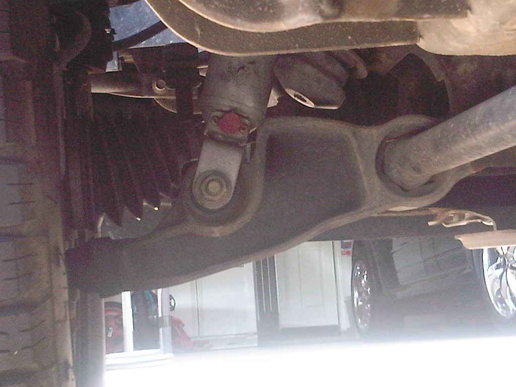

Ok here are the pictures. IT was tough getting under the truck with a spained ankle. Last one is my foot.
IMG 20120322 00228
IMG 20120322 00229
IMG 20120322 00230
IMG 20120322 00231
IMG 20120322 00232
IMG 20120322 00233
with the car on the drive way there is about a 3" gap. I'll get a better shot of the cvs later today this is the best i have.
