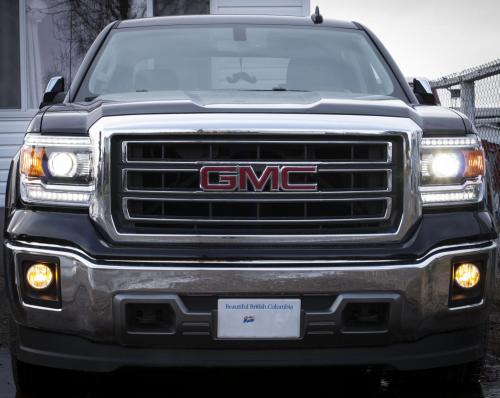

On my truck I installed those new Silverstar XID in both the high and low beams. Was thinking of doing the high beam & fog mod in the fuse box, but I noticed that the color difference from the fogs to headlights was so noticable that the stock fogs looked yellow. (I know that the only real true way of producing brighter headlamps is to go HID, but with nbs silverado's coming back into the dealership to get their headlamps working again, I decided to go the safer way.) I figured if I did that high & fog mod it would look silly with the color difference. So thats why I was looking into the CREE fogs because they are awesome in my reverse and cargo lamps.
