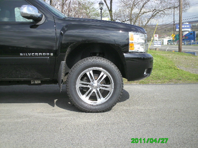

MB2008LTZ,
What are the other specs on your truck? Lift, wheels, tires, etc.....
