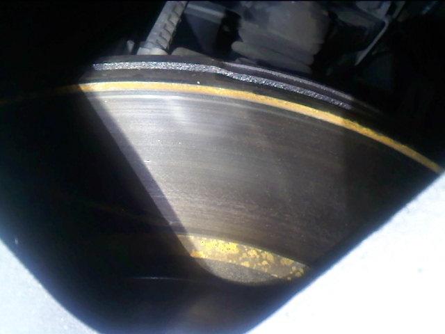

Went out at lunch and snapped a picture of the rotor. It's a cell phone picture and I park in a parking garage so the quality and lighting isn't great.
The rotors in person don't look to be glazed/polished that bad. They don't look any different that what my factory ones looked like. They are silky smooth to the touch though.
