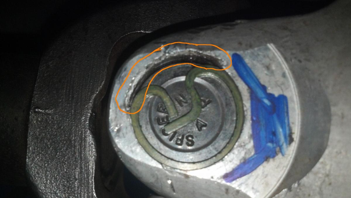

So my front u joint on my rear driveshaft needed to be replaced so I figured since I had a press it wouldnt be a big deal. Well it wasn't for the most part, except for when I go to put the snap rings on the shaft end
Follow the orange circle, the blue was so I could identify which side was messed up
I guess when I pressed the old u joint out, I must have take some of the aluminum lip with it. My question is, is it safe to leave it like that, or should I fork out the money for another driveshaft?
I reinstalled it and drove on it for about 5 miles, and it seemed fine, but Im just not sure if only a little less than 3/4 of the circle will hold the clip in place and hopefully keep the cap from shooting out and destroying a whole lot of everything. Good news is, it doesn't make a squeky noise while driving it now! Haha
I would leave it but that's just me

If your worried, you can weld up a catch all for your driveshaft like some racers do.
looks like the clip is not in all the way to me ,ya might wanna fix that

The round part of the clip is set in there pretty good. Used a punch to get it in so it is definetly pretty tight in there.
No salvage yards around me have another driveshaft. I did check eBay though
