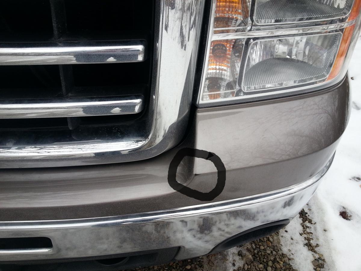

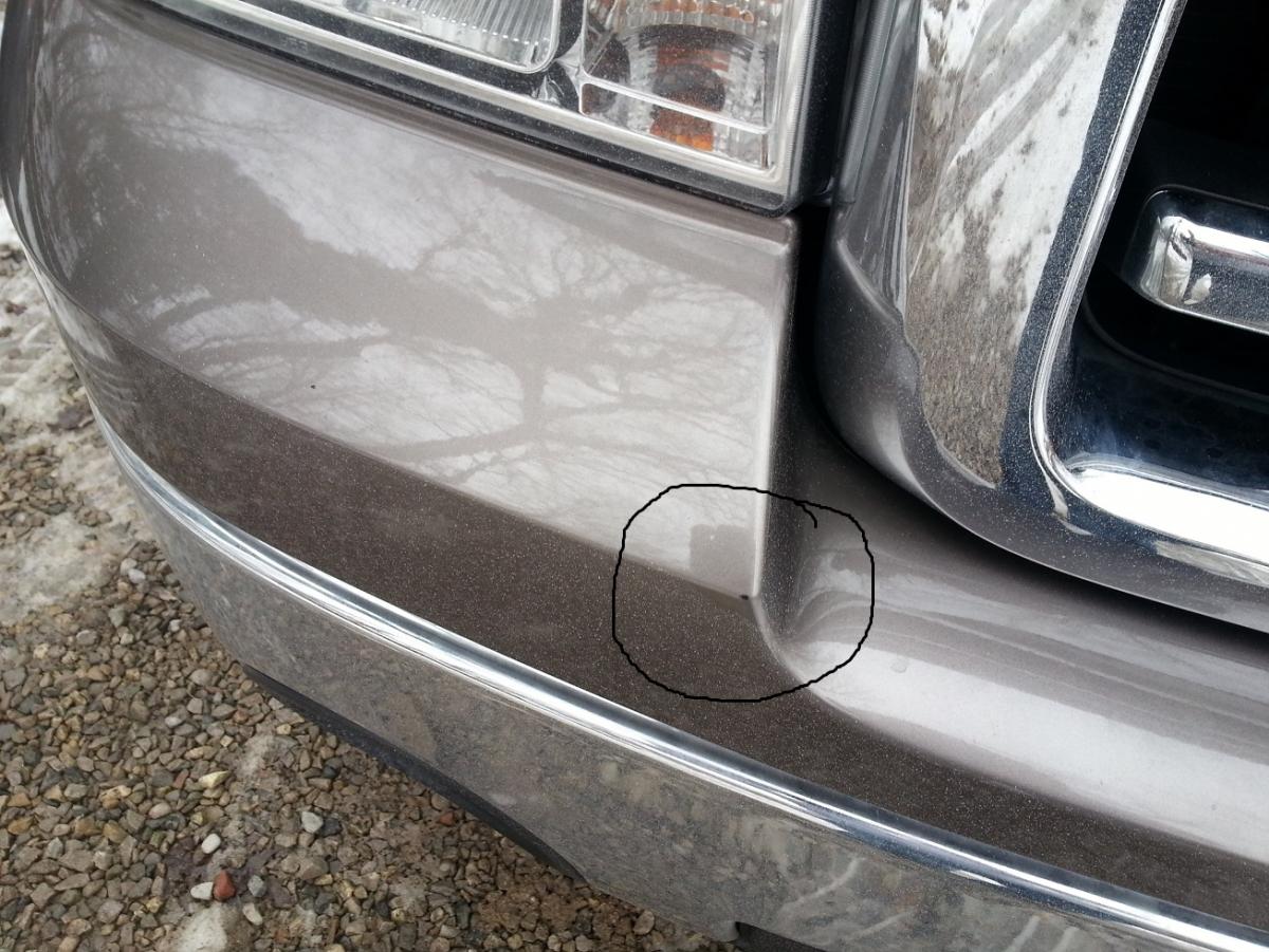

I have a few marks on the front painted upper bumper area that seems strange to me, It hasn't been scratched or hit, It's on both sides and almost seems that it's worn through...A couple pics for reference. Maybe i just wash it to much...
Looks like someone got a little happy with a buffer.
Agreed, the paint in the edges are thin. Got to close and burned the paint.

Thanks for the help, it makes sense that it would be a buffer, i bet the dealer did it in prep. for the sale. bought it used 2 months ago... Never noticed it then.. thanks! RCR
im no detail guy but im assuming that touch up paint can go on and then polished smooth,,,
am i rite ? i thought i heard that awhile ago

at least it's plastic and wont start to rust, i'll try to repair it in the spring when it's a lot warmer out, thanks for the input! RCR
